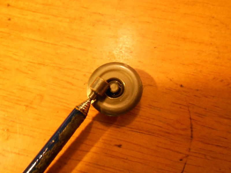

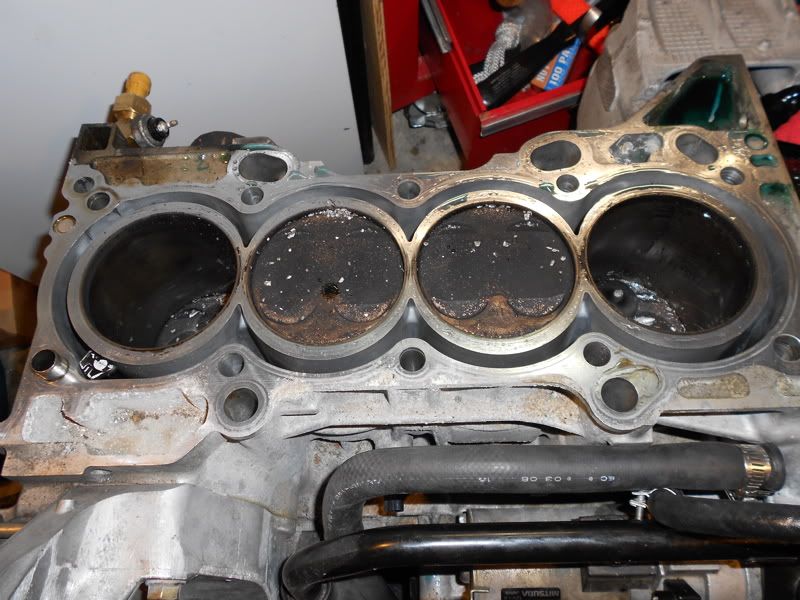

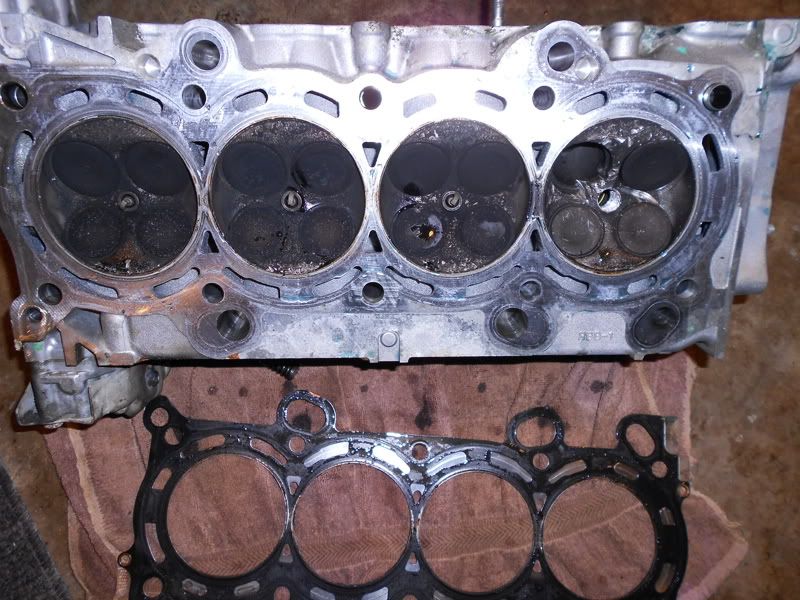

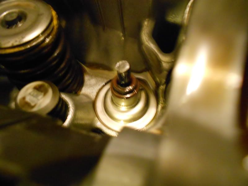

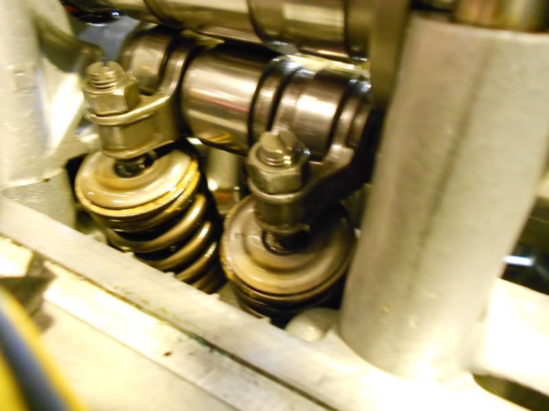

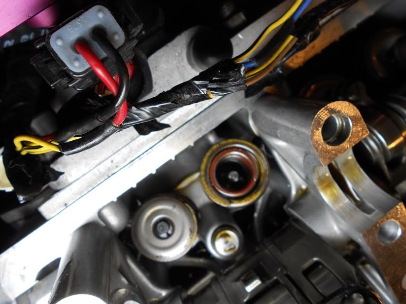

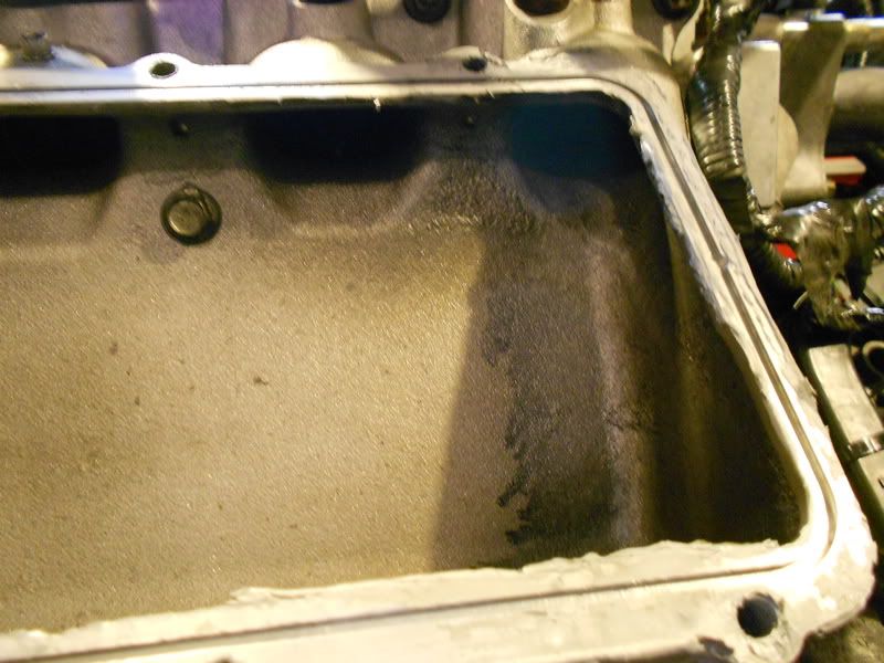

Here's a nice updated on the car.  A few weeks ago I got the motor back in and things were running fine when I first fired it up and let it run to purge the air from the cooling system.  Then I drove it to get gas and things were still okay.  The next morning, I went out to get breakfast and things went very very wrong.  One of the intake valves on cylinder 4 broke below the keeper and the valve dropped, causing a bunch of damage to the combustion chamber and piston.  So I pulled the motor and took the head off to find this:
Not a good sign that the valve spring was still de-compressing as I was taking the cams out.
You can see that the valve stem and keepers were still in the retainer when I pulled it off.
Here's the broken valve stem.  This was definitely the cause of the problem, but how bad is the damage?
When I pulled the supercharger off, I found more of the valve in my intake manifold.
Here's the extent of the damage to the head.  It's pretty much trash now.
Here's the damage done to the piston.
Now it's time to completely rebuild the motor.  My plans are in the OP.
