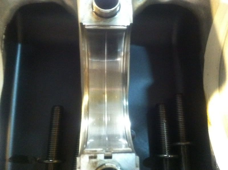

Here's a few pics from the rest of the tear down of my block.

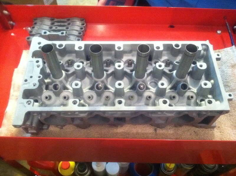

This is my new k20a2 head.  I just got the bare head and rockers since it was a damn good price.  It had a bent valve, so one of the valve guides is damaged.  That will get replaced when I get it ported and polished.  So far it's been glass beaded and hot tanked.

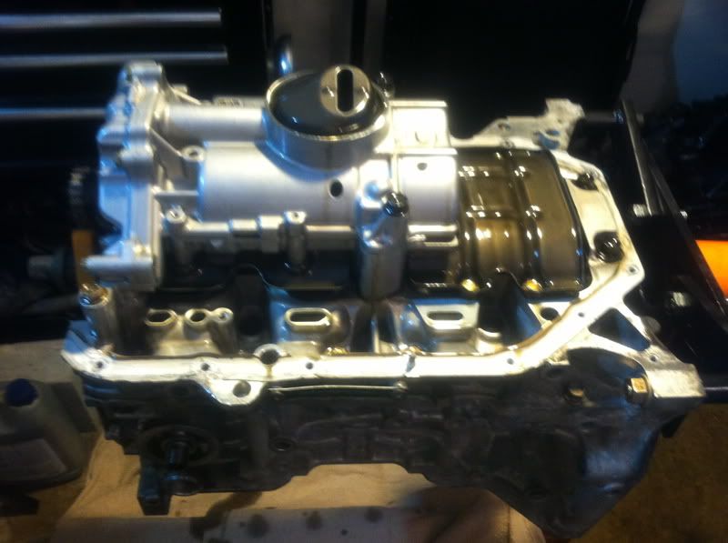

Here's a shot of the oil pump before I pulled it off and split the motor to pull the pistons and crank.

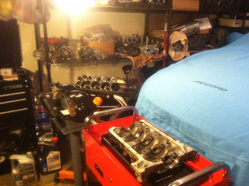

Here's my motor all torn apart.  There's another shelf full of parts that's cut off at the top of the picture.  You can also see my other K20A2 head and my old tranny case off to the right.

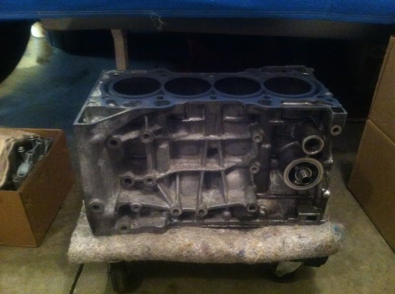

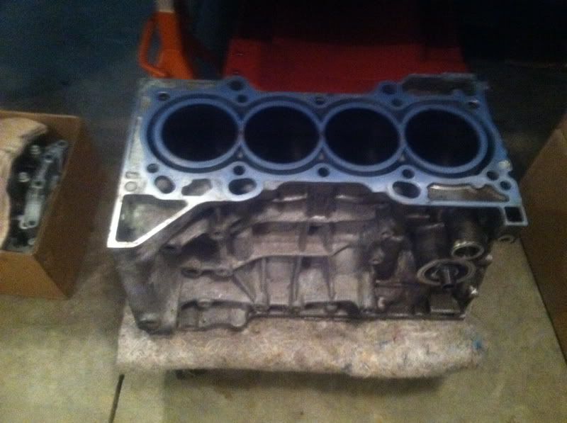

Here's the bare block now.  I've gotta get it ready to drive down to ERL to get it sleeved.

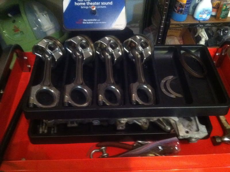

Here's the pistons.  I'm going to remove the pistons and have the rods checked.  I may be able to save them for another build, or sell them to fund this one.

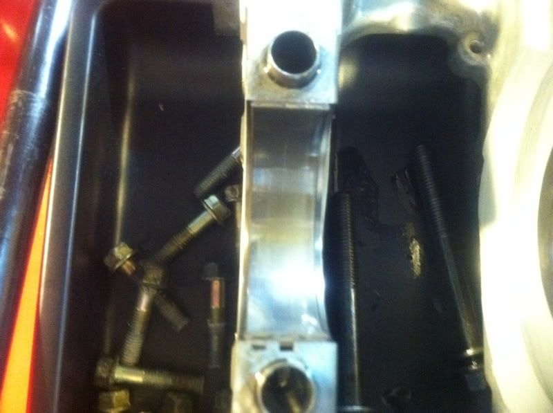

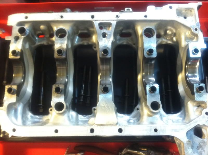

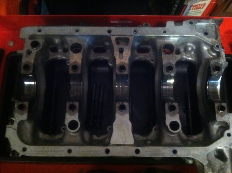

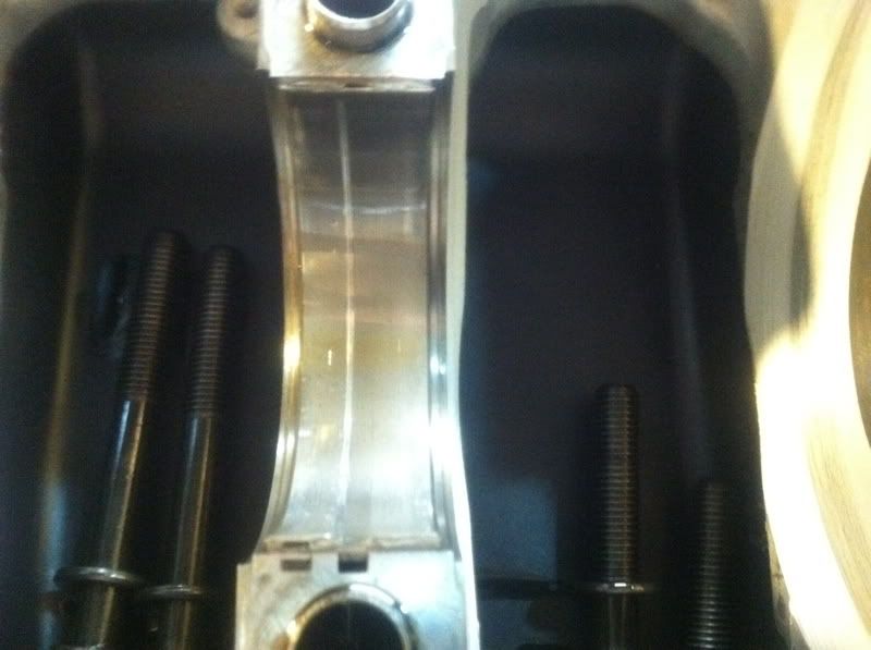

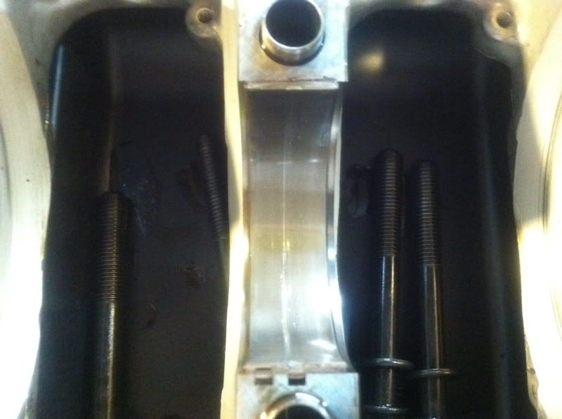

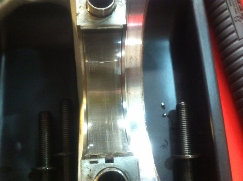

Here's the block girdle.  You can easily see in the following pictures that the bearings are scored.
