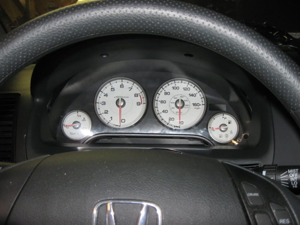

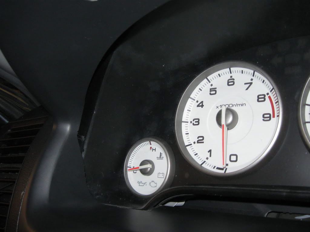

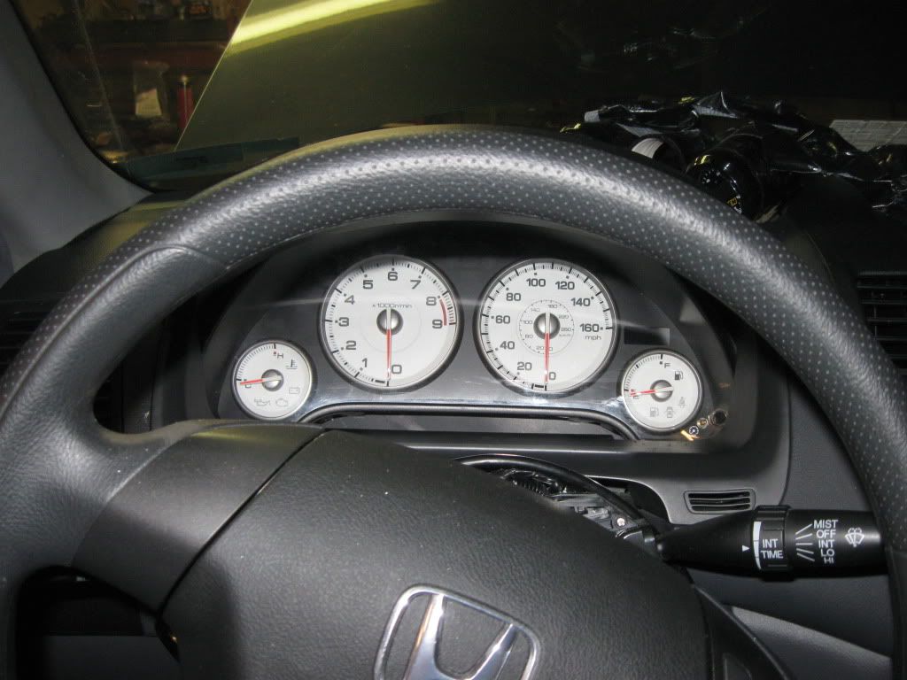

September 01, 2009, 12:29:31 PM »
NICE!!!! RSX Gauge? Where do I sign up lol?
