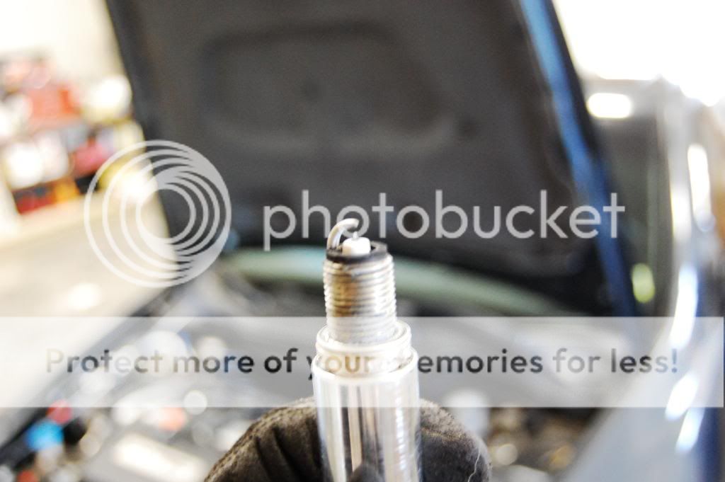

Go to a conventional 10W-30 like castrol, I reccomend that even with my engine builds, the 5-20 is too damn thin when the car gets to full op temp and synthetic is even worse at thinning at temp, but it sounds like you rings are ging causing the oil loss, when you pulled the plugs what did they look like, can you pull the plugs now and take picks of them being sure to mark what cylinder they came from.

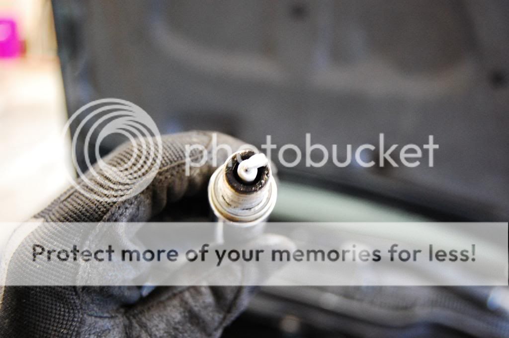

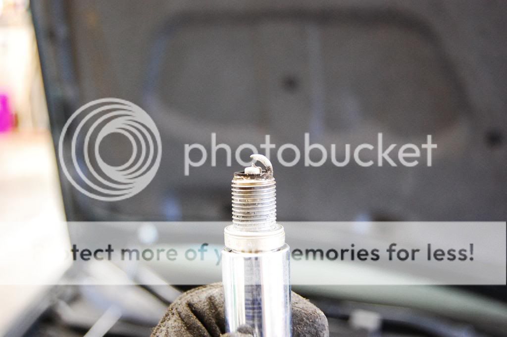

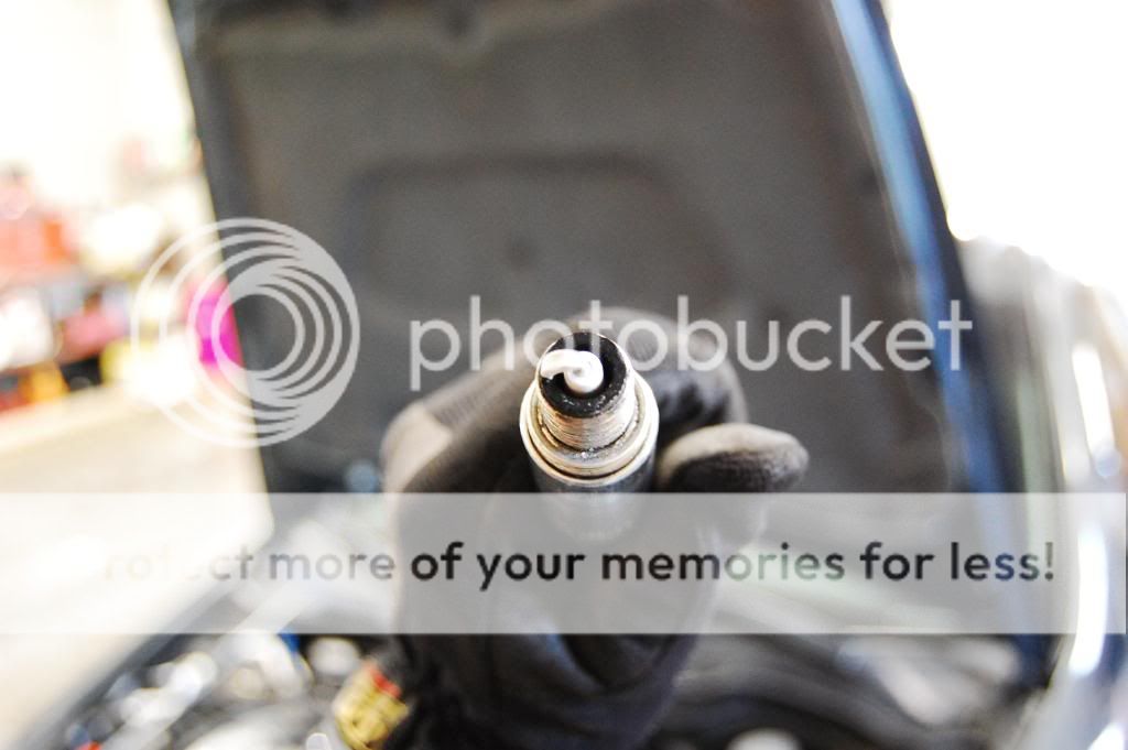

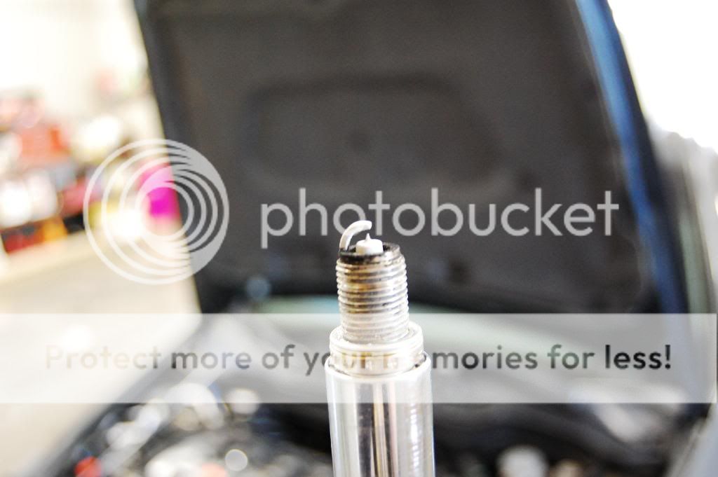

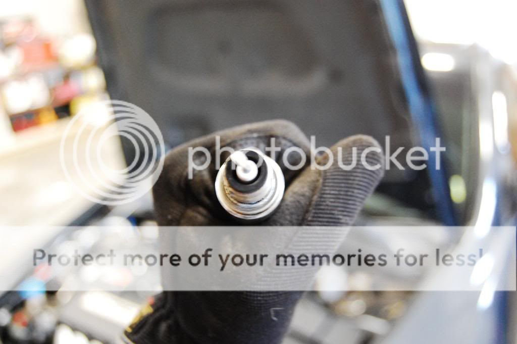

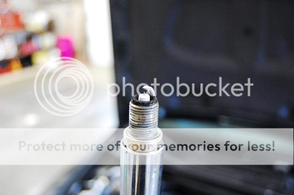

Quote from: "NVA-AV6"
Cylinder #1
Cylinder #2
Cylinder #3
Cylinder #4
All of the electrodes were still very pointed and looked fine.

April 15, 2009, 02:10:58 PM »
that's the new set?
T
X
Squad #
flick
r
fb
[img]http:
Slammedk24
Posts: 164
Re: Oil Burning
April 15, 2009, 02:18:25 PM »
Yeah they 26000 mile on them
