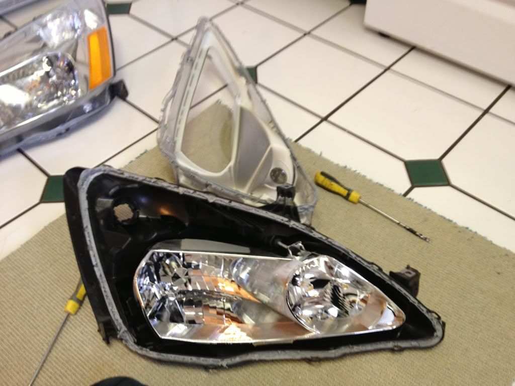

Took apart my '07 pristine OEM headlamps...gotta get her ready for when the new projectors deliver...little sad but I know
good
things are comin'!
Last Edit: April 17, 2013, 12:35:01 PM by DreaminAccord

Reply #6784 on:
April 17, 2013, 12:30:54 PM »
Spill the beans already fucker!
