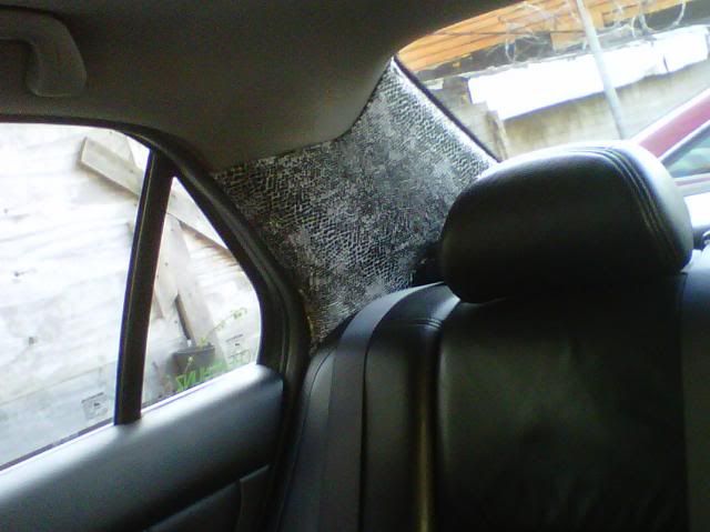

I took out my interior panels (2 in front and 2 in rear
Edit: was able to get the center pillars out where the seat belt goes into as well
) and wrapped them in some nice fabric. Came out freaking awesome. I love my car again!!! It's all coming together slowly but surely!!! Pictures to follow soon enough, I forgot my camera home lolz
Edit: Here are 2 pictures for the wondering eyes...
Last Edit: April 24, 2013, 09:11:46 PM by CrazyCreashunz

You better hurry up with those pictures!!

Updated above with a couple of kodakz

Looks good man. What fabric did you use and how did you do it? Contact cement?

Thanks,
I basically removed the 6 panels and cleaned them up. I then wiped them down with rubbing alcohol as well. I went to a local fabric store(s) until I found something I liked and would flow with my car. Make sure you cut a piece to wrap that piece of the panel before doing anything with the adhesive. Once you get the piece cut (leave some overlap). I used 3M 77 Multi Purpose spray adhesive. The trick is to spray the piece evenly and wait 30 seconds before applying fabric. Try to get it on as evenely as possible so you have no ripples in the fabric, smooth and lift as needed. Do this to all pieces and when your done reinstall into your car. As for the fabric I used a thicker piece. It almost feels like micro suede... Don't get the fabric to thick as you won't be able to secure the panels in place securley. The poject should take around 30-45 minutes tops
and will definetly add some appeal to your interior.
Hope that helps...
