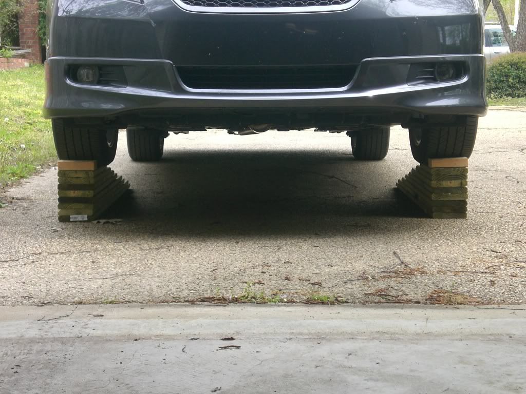

I built some that were 40 inches long that gave a 8" lift. It was able to accommodate a car that is 5" off the ground.
We bolted a 10x2 to the bottom after the pics and some suggestions. They cost a total of $40.00 They are very secure and will not do what the Porsche did.
Re: car ramps
April 17, 2009, 11:04:47 PM »
^^^i saw those on another thread....looks pretty good but i wouldn't need anything that high...i may consider replicating something similar to this
