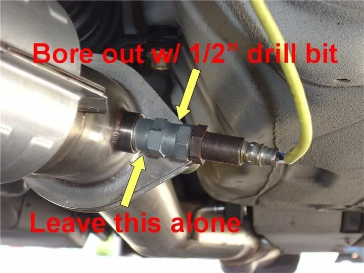

Basically what Bill said. It spaces your secondary O2 sensor further away from the stream of exhaust in your cat. Here are a few pictures to help you get a visual of what we're talking about.
