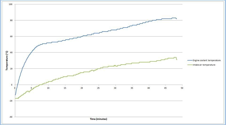

Went back to stock intake system for the winter, hope it solves my check engine issue.

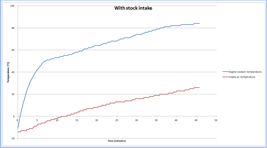

Had a check engine P0128 - Coolant Thermostat (Coolant Temperature Below Thermostat Regulating Temperature), changed the thermostat with new oem one. few days later still comes on. So i decided to let it warm up and datalog intake and coolant temp.
Found out that because of the short ram, at idle, as the car warms up the air in the engine bay gets hotter and the iat sees the temperature hotter than it really is.
My theory is that the ecu thinks that the outside air is warm and the engine should warm up faster according to the datas from the IAT and ECT.

Did another datalog today with the stock intake now in place.
I did not expect that :S
The IAT reading is almost the same, just a bit colder through the curve but I doubt the short ram intake was actually the issue.
The check engine light hasn't come on yet tho, It almost always came on when I was parked in the underground parking of my university for a few hours, I'll try that out to see if comes on with the stock setup.

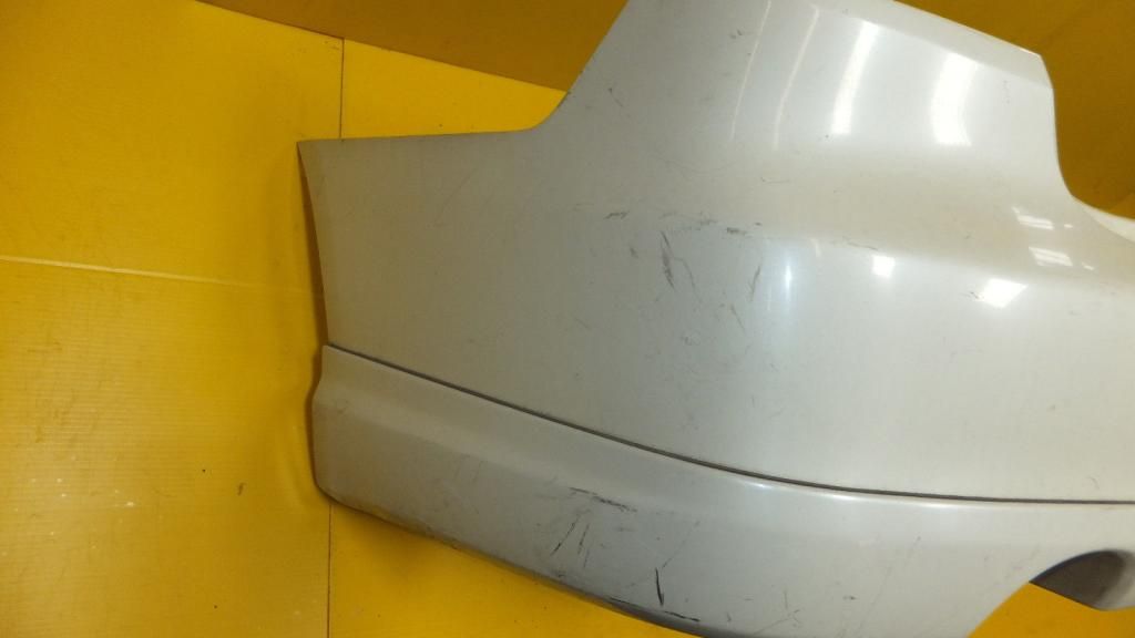

I'm tripping balls !
Here are some pictures of the bumper/lip and how it will look on the car

Received the bumper today by the Canada post lady. she needed help to get it out of her ford transit. It took almost all the space in it
I have to say, I can't wait to get it painted and put it on !

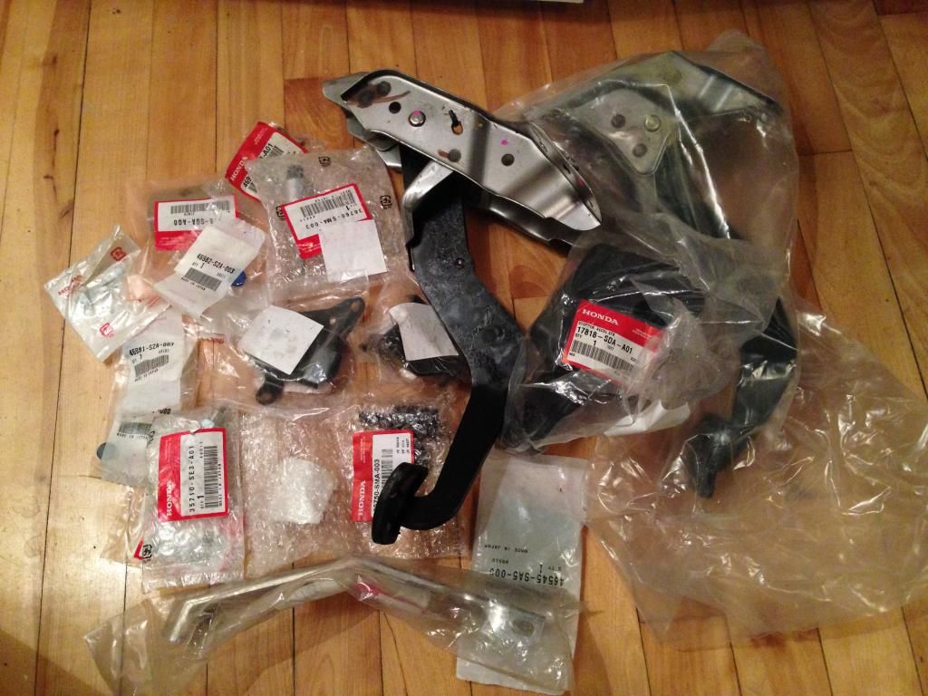

More parts today, for the 6MT conversion
