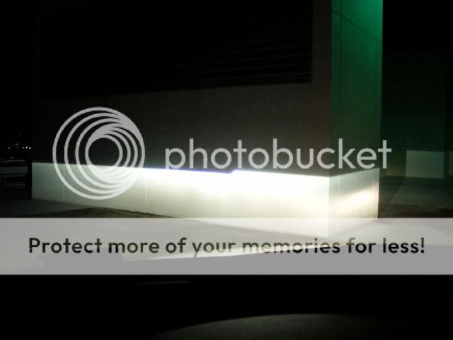

secret projecto that is sitting in the garage.
