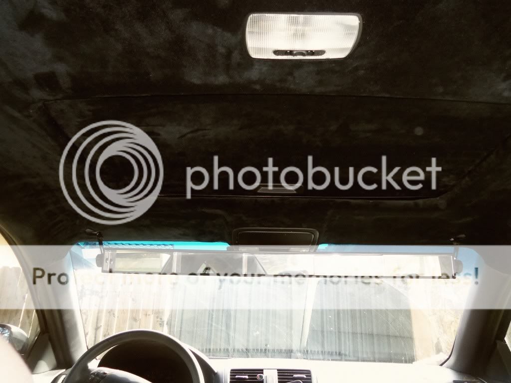

after looking online for any type of PDf or instruction I couldn't find anything, all the pdfs are for the headliner, only shows the headliner & not the sunroof cover... so I removed the whole damn thing, to find out i could have taken it out, w/o removing the whole sunroof assembly, and decided to take pics as a step by step for a how to.. and here you go

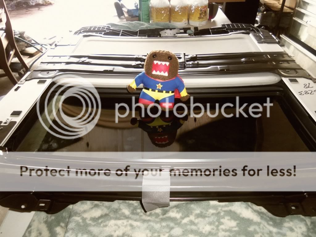

Super domo says Dont do this... you
WILL NOT
be able to get the window out, one of the torque screws will be blocked...again dont take out the whole assembly..

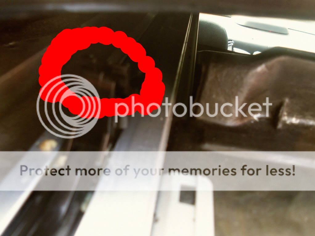

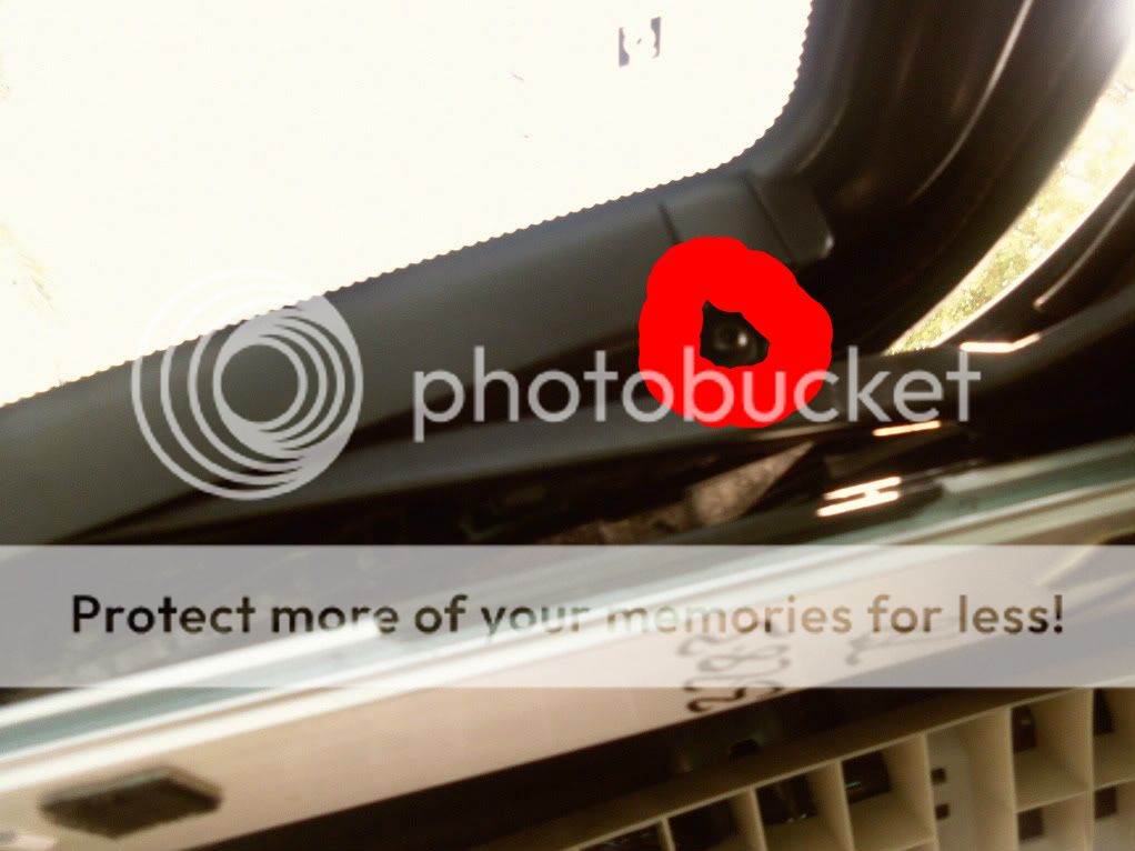

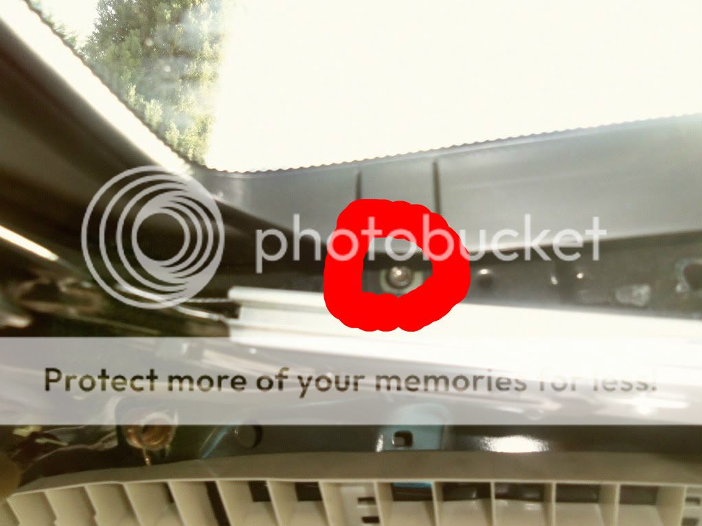

circles here are the torque screw positions...

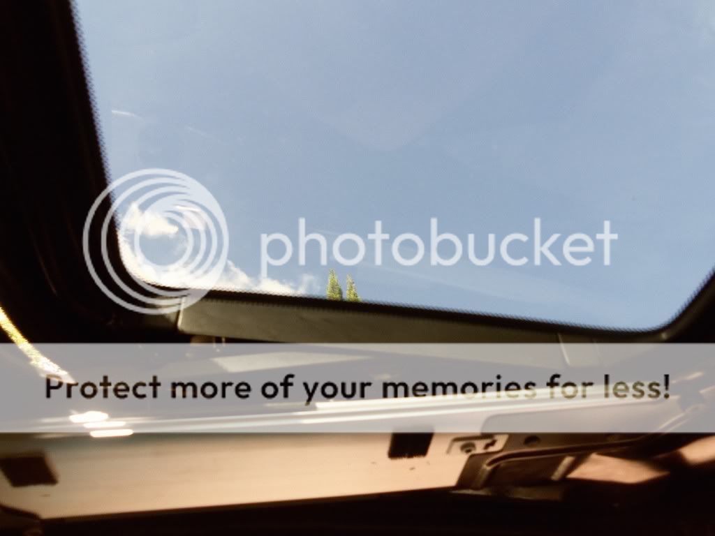

Start here...

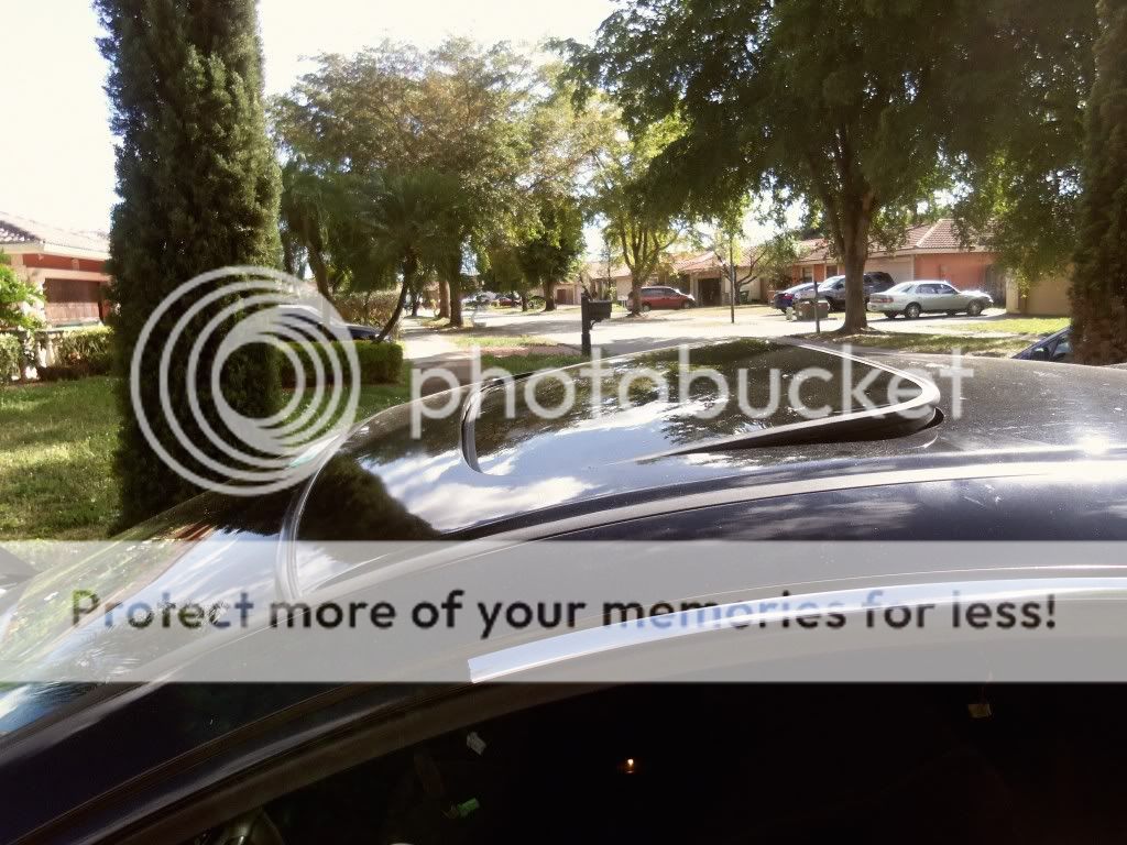

tilt sunroof like so,
once tilted you will be able to see the screws as seen here
once all are removed angle the glass to be easier to grab from the top like so
grab a blanket or something that is thick but soft so you dont scratch the glass

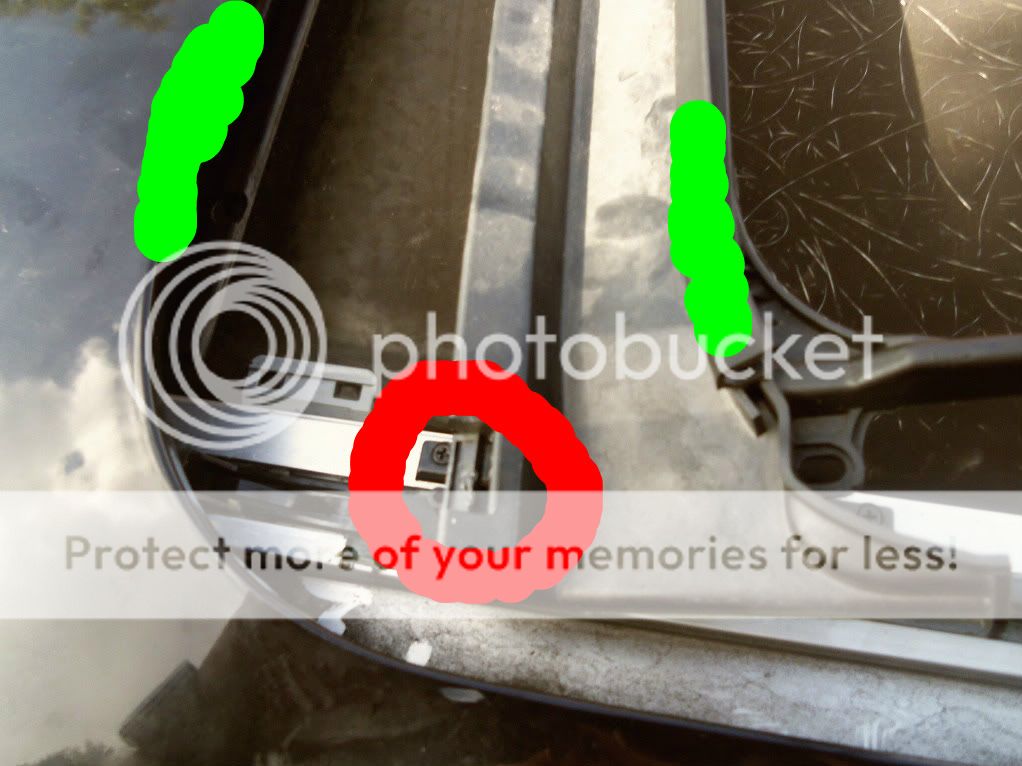

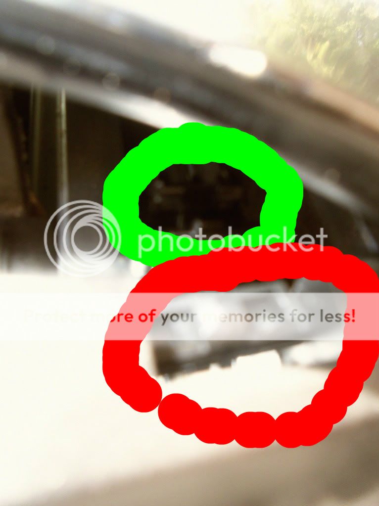

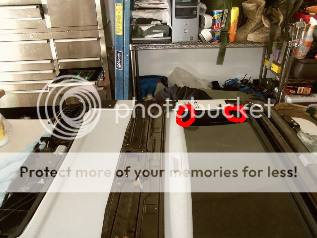

once removed you will take this of, it sits on the front on the sunroof,
green shows where it was, red shows where the 2 philips screws are (one on each side)

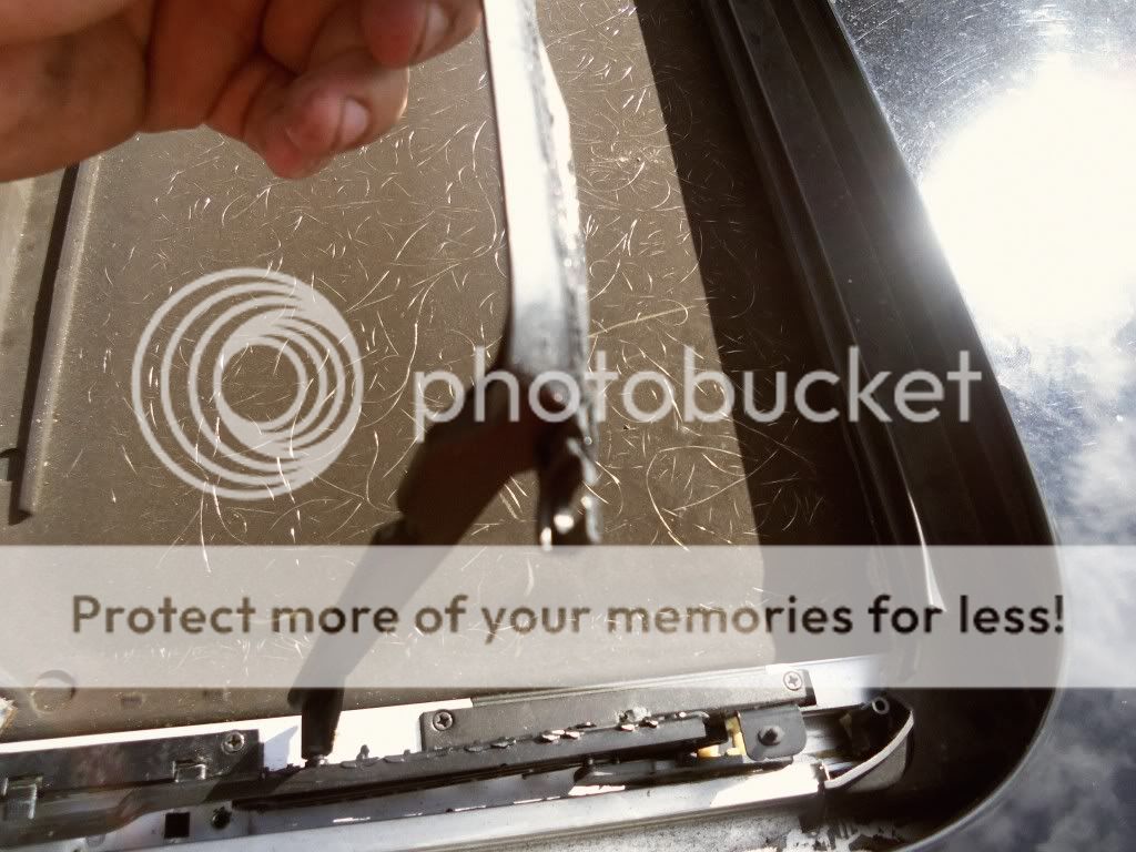

next its time to pop off a piece from the back of the hole, as shown here.
BE CAREFUL!!!
Remove like this..
or end up with this
once you take em off leave them like this
once those are off you will have to pop it off the rail, to make it easier, slide the plastic you just took off towards the front of the car as much as you can then make the green in the 1st pic touch, start on the left side...
Left side
where it was hooked to rail
Right side, green where hooked to rail, red where piece hooks into that green piece

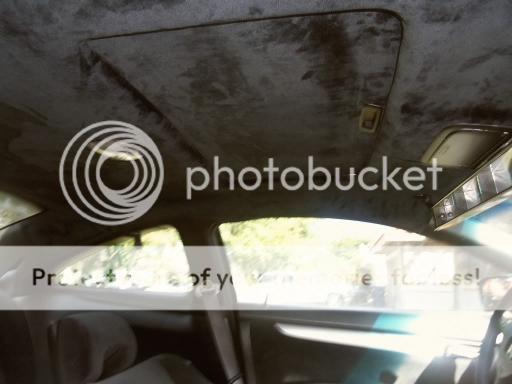

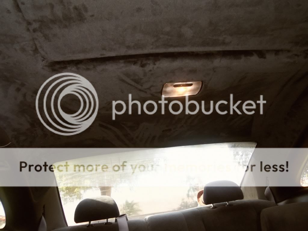

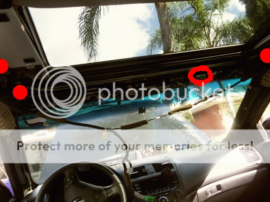

once done, sit in car, remove screws W/ the ratchet,that hold in the sunroof assembly as shown here, the one in the front, then the first two on each side, then remove one more on the left side, should be right above the pillar where your seatbelt was,
note
the sunroof assembly will come down a bit on the front, its ok, you can put one hand on the crossbar that is on the assembly, to make you feel more comfortable if you want....
forgot to take a pic of where the screws, so here is a mock up with a few of the positions..the screws should be a goldish color, was for me..... if you still need help, then wth...
once removed, you can slide the sunroof cover off, once you get the edge of the sunroof assembly and you have a bit of difficulty, its ok just wiggle it slightly while pulling, it will come out...

you said you found out you can remove the sunroof cover without removing the whole sunroof itself? but according to the pics it looks like you removed the whole assembly.
Re: How to: remove sunroof cover
February 10, 2014, 11:20:12 PM »
look at the pics closely. you will see that I put the whole assembly in the car, and the raason why I had to put it back in the car. I show you only what you have to remove..
