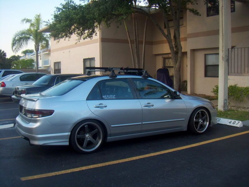

sorry about the quality of the pictures..i haven't posted up the car in a while so here are a few shots with the new wheels i picked up.. i also did the oem navi conversion and swap out all my interior for a 2007 ex-l interior also in black leather..i also changed the steering wheel to the 07 with the navi controls on it..i now have to wire power to the steering wheels so i can get lighting to the steering wheel contols..
the specs on the wheels are:
Axis Hiro's
Fronts: 19x8.5 +35 offset with 235/35/19
Rears: 19x9.5 +40 offset with 265/30/19
Navi Installed with 07 steering wheel..

not much..it actually feels really good getting into long curved ramps at high speed..it has alot more grip than when i was running the tl-s with the 235/45/17 i had on them.. and in sharp turns it responds very well too..

Love the new set-up but I can't believe you can get away with that offset! How much camber are you running in the back? I'm only 19x8 +30 in the back with the fenders rolled yet I still rub. Can you take a picture of where the quarter panel meets the bumper? That's where I'm rubbing really bad and I can't seem to get the fender rolled any more. How bad do you rub in the front? With a 45mm offset and a slight pull I still rub over dips.

love the wheels but hate the offset, just cause i know you will be rubbing alot and you can only lover it so much. How much of a pain was it installing oem navi

im running stock specs camber in the back with the wicked camber kit..and the front is stock without any camber kit. the reason that you are rubbing is because of the 30+ in the back..im running +40 for the back on a 9.5 wheel so it sits deeper in the wheel well oposed to the 30+ causing it to stick out more..also remember i had 20x8.5 and i had to shave off part of the inside of the bumper were it meets the quarter panel just a bit..so it was able to clear those.. and in the front im about 1/4 inch pass the fender but it dosent rub at all i only pushed back the tab for the fender liner and called it a day..
