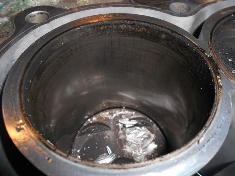

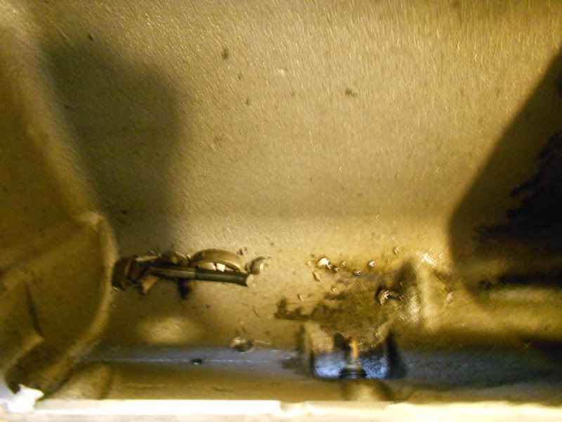

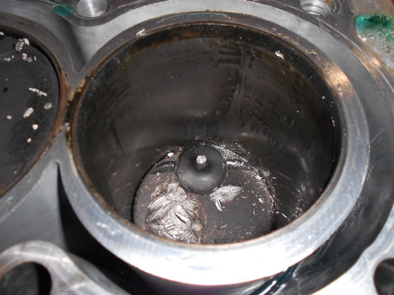

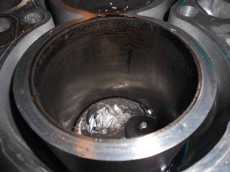

I pulled off the supercharger and intake manifold so I could pull the head and see how bad the damage is on cylinder 4 after I discovered that my motor dropped a valve when the valve stem broke below the keeper.
This was what I found in the intake manifold after I pulled the sc off.
Here's the damage in the combustion chamber.
Here's the damage to the piston.
Now I get to put the motor on an engine stand and start tearing it apart.
Looks like some machining is in order for the head (maybe) and a new piston. That sucks to see Tim.
« Reply #4014 on: October 23, 2011, 11:03:50 PM »
No machining on the head.  It's pretty much junk at this point.  Too much work and money to even think about repairing the damage to the head.  I got the go ahead from my wife to build my motor. So, I picked up a bare k20a2 head with nothing but the rocker assembly.  I'm going to have that ported and polished and get a 3 angle valve job done on it by the machine shop that's going to be honing and decking my block.
Anyway, I pulled the tranny off the block.  I was going to put the block on my engine stand to finish tearing it down, but one bolt wasn't long enough.  I've gotta wait until tomorrow to go pick up another bolt so I can get it up on the stand and continue with the tear down.  Pics will follow.
