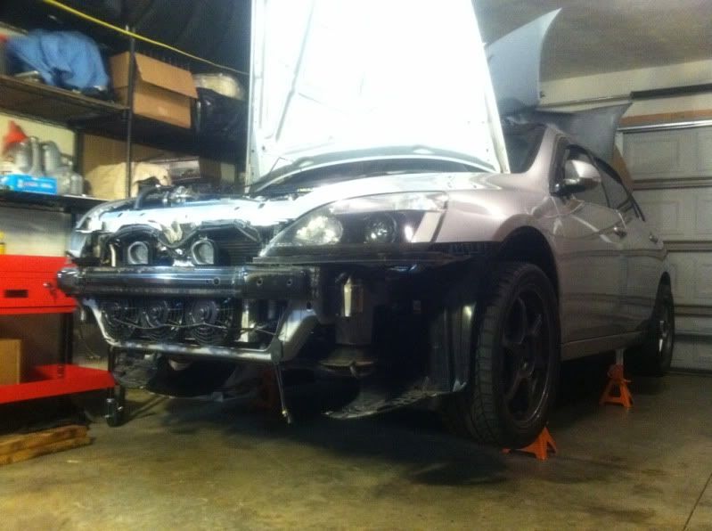

I pulled the axles, pushed it over into the corner of the garage, put it up on jack stands, and pulled off the header.  I'll probably do a few more things later today.  Here's how it sits at the moment.

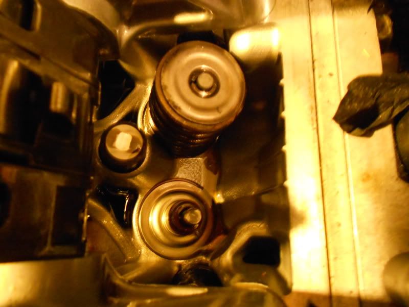

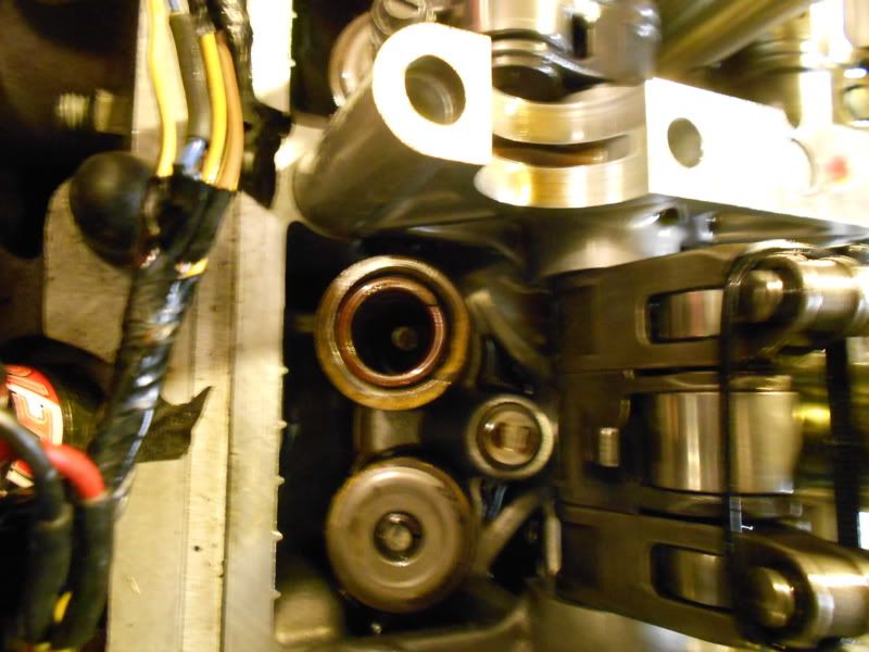

I pulled the motor out today and took the cams out and found out what went wrong.  Here's what I found.
The first sign that the valve stem was broken.  The spring on the left kept uncompressing as I loosened the cam caps.  When I pulled the cams out and raised up the rocker, I was able to pull the retainer right off.

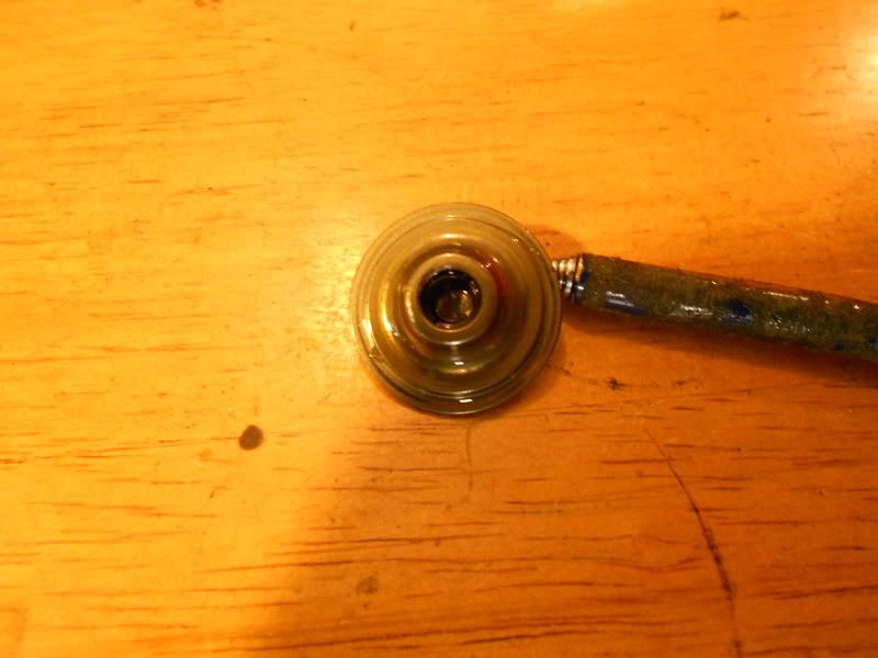

Here's the retainer with the top of the valve stem and keepers still in place after I pulled it off the valve spring.

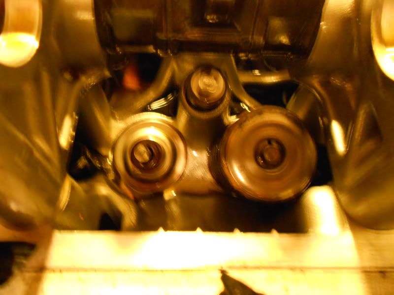

You can see the rest of the valve stem if you look inside the valve springs.

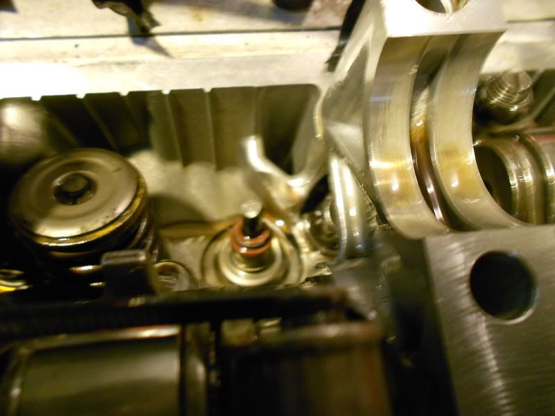

Here's a better look at the damage up top.  I'm worried about what I find when I pull the head.
