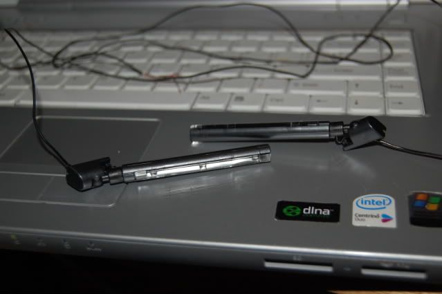

i still do want to light up my cubby with the LED adapter i got, but I want to wire them into my neon lights also (1 plug for the LED and neon lights.) the thing was I couldnt get the LED's to light up.

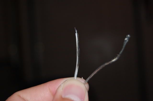

2 black wires, but theres another 2 in each (total of 4 wires.) a blue wire and copper wire in one, a red and copper wire in the other. I assumed the red and blue were my positives and my copper wires were the ground. so with that mindset, i wired them to my neons lights and the neons worked fine, but the LED's didnt. Any suggestions would be great.

...sounds like you bought a bunch of those autozone special neons that work off the cigarette lighter...
You should just have bought cathodes or neons that you can wire in...and if you really needed to be able to turn it off, throw a switch in the middle. You can probably cut of the 12v adapter plug and wire them directly, but be cautious, most of those have resistors hidden inside the plug, so you need to check the rating of the noens

LED's are diodes, so current will only flow in one direction and will not flow in the other. You probably wired them in reverse. Wire color doesn't really matter because it's not exactly universal. You should probably try and show us what you have. Usually stuff comes with some sort of wiring diagram or schematic. I would refer to that first.

LED wires (for 2 seperate LED's)
LED 12V adapter
neon light wires (wire on the left has the white stripe)
neon 12V adapter
what i tried to do was take the copper colored wires and wire them with the white striped wire. did the same with the remaining. if wiring the LED's aren't possible with the other wires, what would you suggest?

What kind of LED's are these?
Re: Custom Cubby Hole and 12v Adapter
April 18, 2009, 12:03:46 AM »
theres 3 LEDs per "case." they're from autozone (dont care about the store, its just lights.)
