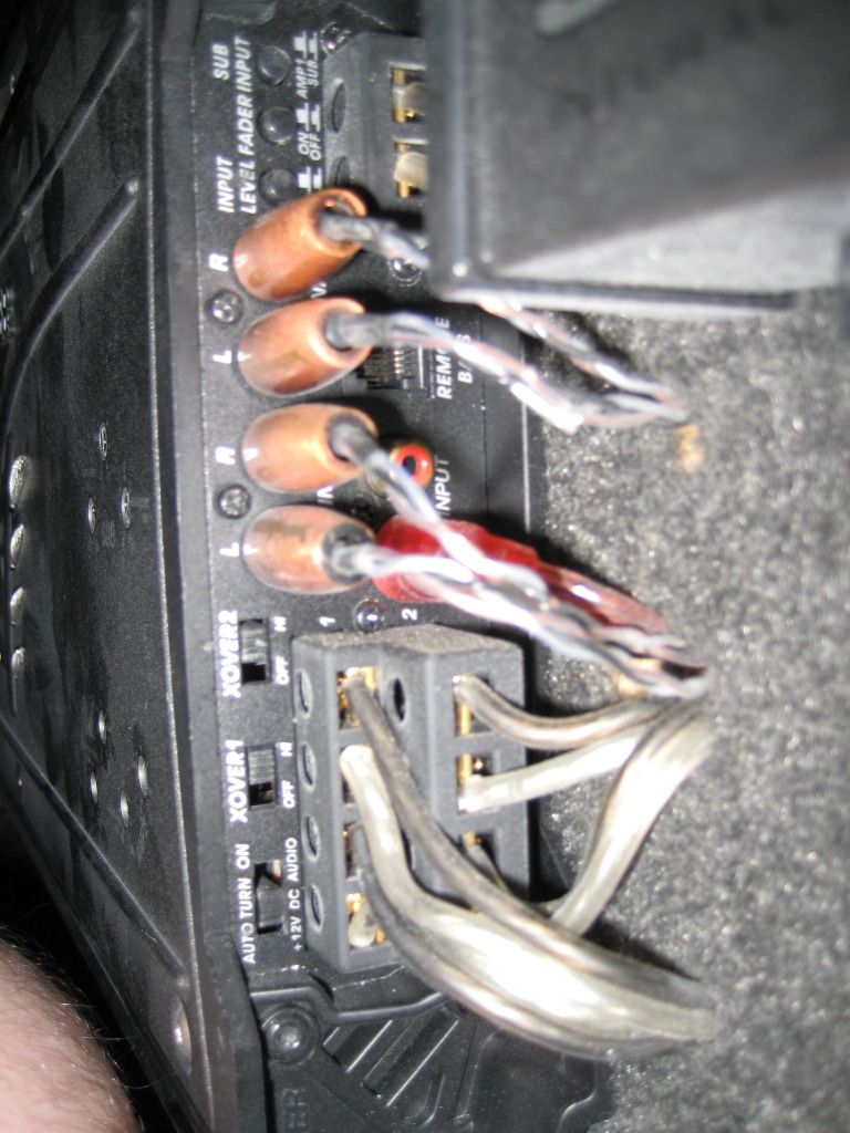

These RCA wires run to the amp

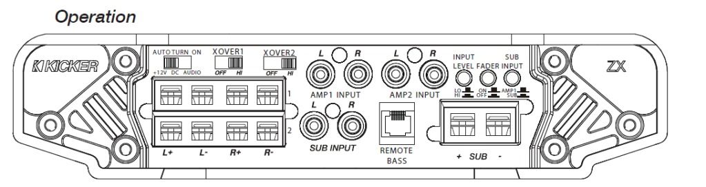

Amp:
Reference pics

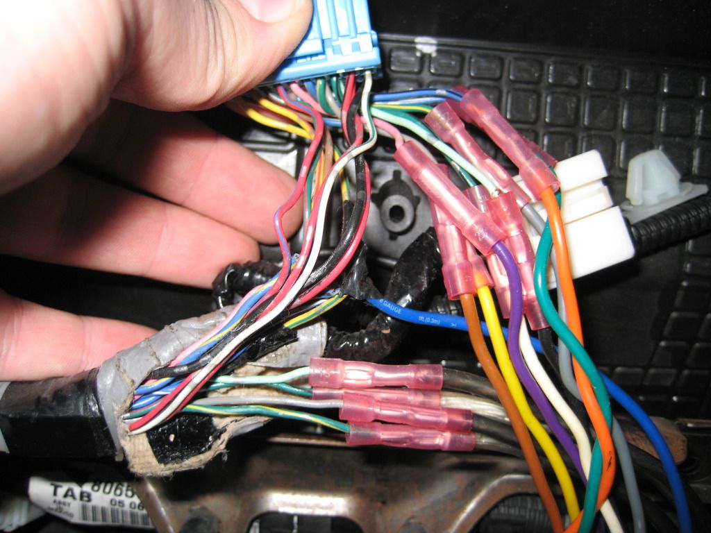

You're talking about these wires right?
Thanks, I'll give it a shot.

After that, I just need to remove the RCA plugs from the amp and I'm good to go?
Re: How to UNinstall a RF 360.1
November 07, 2012, 10:29:31 AM »
Yes those wires , if you going with a aftermarket radio the rca's will plug into that

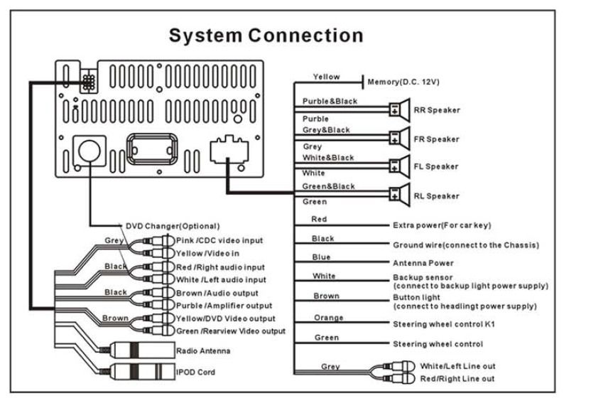

Found this wiring diagram in the manual. I guess the only part I'm a bit confused about is what wires I'm supposed to use to hook the amp to the head unit. You said to run RCA wires but it doesn't look like the HU has anywhere to plug them into.
Re: Re: How to UNinstall a RF 360.1
November 07, 2012, 03:43:49 PM »
The audio outs on the right side should work.

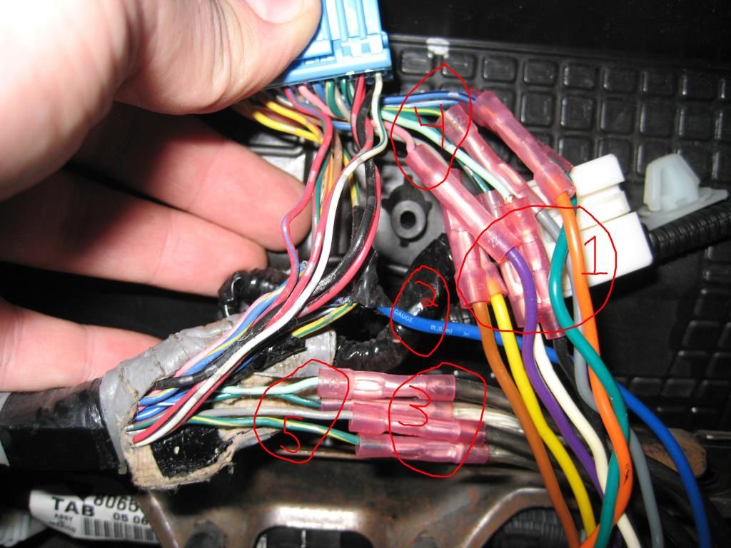

OK... on my lunch break I tore down my center console and traced the 360 wires to this connector. Here is what I found.
So using the picture above, what I need to do is disconnect 1 (wires from 360), 2 (same), and 3 (wires for front and rear speakers ran from amp)? Then reattach 4 and 5? What after that?

November 08, 2012, 02:07:16 PM »
That is correct basically you will reattach the oem ones and take off the 360 ones , since your installing a aftermarket head unit . The aftermarket head unit will connect to the oem harness but since your using a amp you will run its rca's to the amp and from the amp back to the speakers

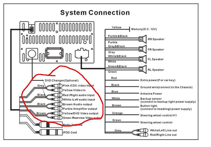

Quote from: cna on November 08, 2012, 02:07:16 PM
I'm confused about this part. There doesn't appear to be anywhere on the HU to plug in RCA cables from the amp.
November 08, 2012, 02:20:17 PM »
Unless that is what these are for? The descriptions don't make sense though.
