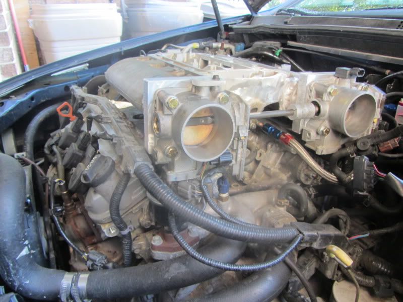

Well the prototype is built and when plugged into the car it did not bitch. Unfortunatly I need the accord for tonight so bolt on and run testing will have to wait until tomorrow AM.

Ok, first test report....
60 miles mixed driving with several hard excellerations, ECU reset at start of testing.
The good:
Emmissions monitors were all happy and would pass VA emissions test.
No codes were thrown.
Throttle response was incredible but held back by lack of volume in stock maini plenums.
Excelleration was majorly improved.
Sound at WOT was extreamly pleasing, deep and throuty.
The not so good:
Stock mani is woafully inadequte to deal with the increased air flow.
Front TB in the way of EGR valve, rear TB in the way of breather port, but this was a basterdized intake made to mainly test if the ECU and mechanics would work together, mani will be trashed at end of this phase of testing.
Without any adjustments yet (will be worked on latter, idle is a little higher (about 100RPM), but not rediculously the ECU is working on adjusting for it.
Due to the major increase in expected air flow when the engine idles up for things like AC, PS it nearly doubles the normal 200rpm rise and instead gives a 400rpm rise which acts as a small surge and can be anoying at idle, but again the ECU seems to be working on compensaiting for it.
More to come.

Well, I started cutting another mani apart and made a die set so I can form horns on the end of 2" aluminum tubing. Should have some pics today.
