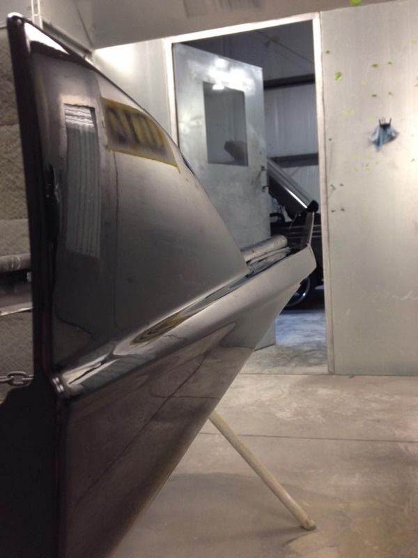

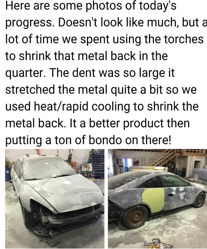

"After all the body work is done it'll get sealed like the dodge in the background of the picture then it should be block sanded to double check for dents then resealed base coat and clear then it should get wet sanded and buffed."
Here's an update, talking to an aquiantance who does body work, he said they're doing a good job. Seems like there's a lot of work left to do. I'm guessing they will need to keep it another week.

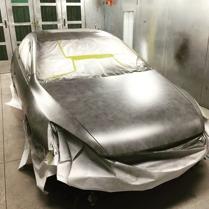

Silver surfer! Lol It was hard but I asked if this could be my last pic from the shop. I don't want to ruin the surprise
What's orange peel?

The paint has the texture of an orange peel. It means they didn't do a very good job wet-sanding and buffing.

It looks like they did a good job covering areas that shouldn't be painted so over-spray shouldn't be a problem.

Thanks for the pic Ike! The visual definitely helps. I've seen that before.
