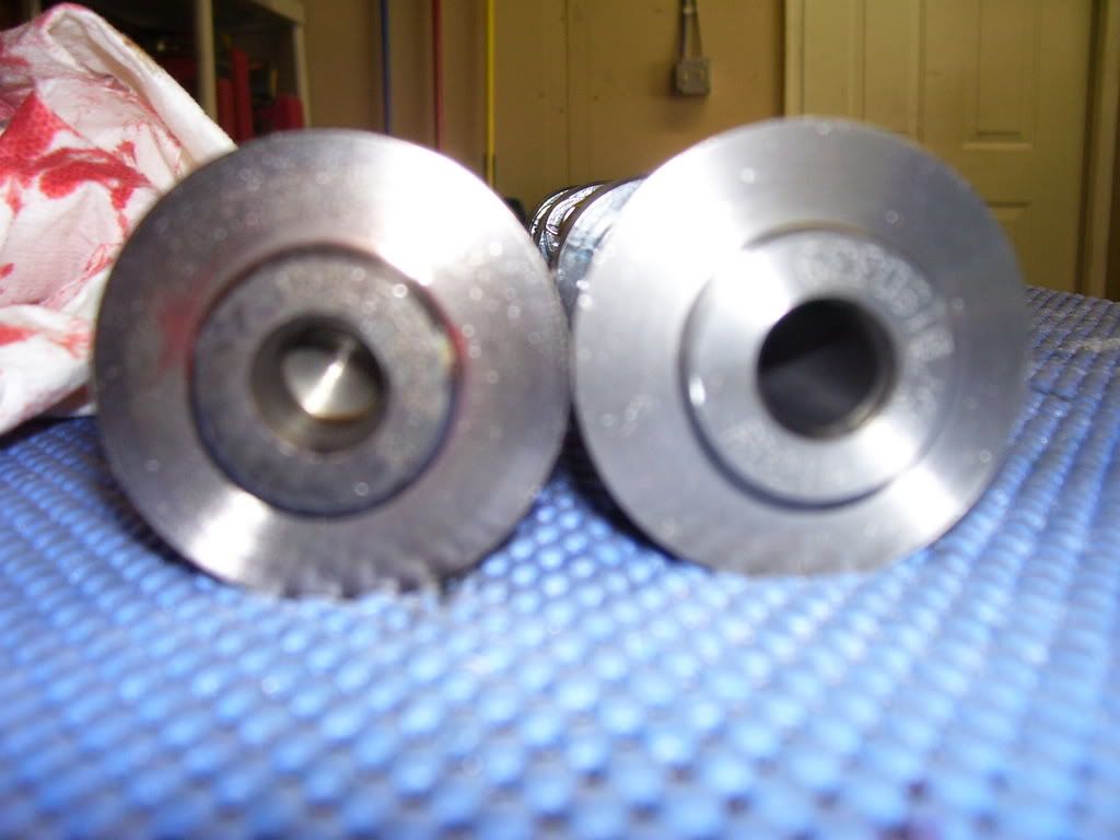

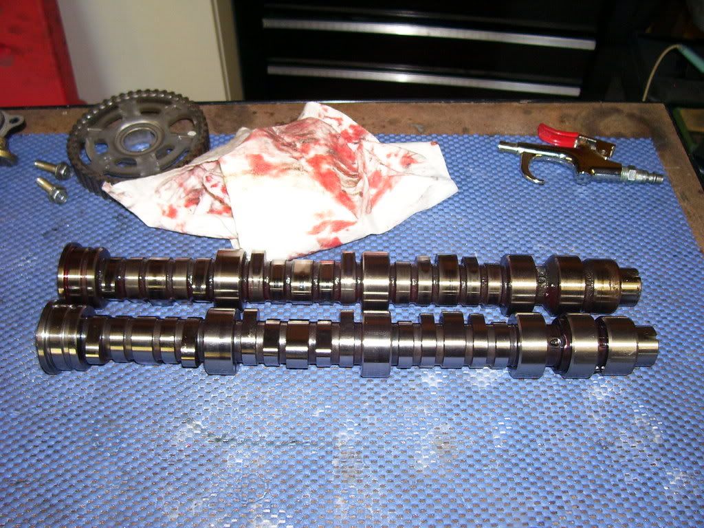

07 TL-S cams fit with no issue. They are lighter and with more duration than the stock cams, because they are lighter this will help with reving in that they will lower rotational mass, not as much as a lightend crank pully, but every little bit helps. There are also no issues with valve clearence. Another valvetrain piece of intrest from the 07 TL-S are the exhaust valve springs, they are about 15% stronger than the stock springs, this will help alot with over rev valve bending since in that scenario it is the exhaust valves that take the beating.
Observations----
1. stock cams are 6lbs 2oz- TL-S 5lbs 1oz
2. .3mm taller vtec intake lobe and definatly higher duration (don't have the equipment to mesure properly).

On a side note: Paul I have the same blow gun. LOL

Nice info Paul. Is the difference only on the VTEC intake lobe? Are the other lobes identical? I'm guessing you used a micrometer to measure the amount of lift. What would you use to measure the duration?
Re: 07 TL-S cams
February 23, 2009, 06:03:29 AM »
To mesure duration you would use a degree wheel, a good one is about $500 and no I did not see any visible difference in the non-vtec lobes. Also the TL-S cams are forged which is why they can get away with being hollow.
