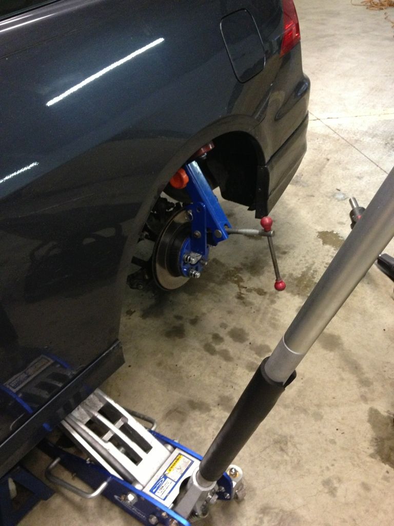

January 28, 2013, 05:05:27 PM »

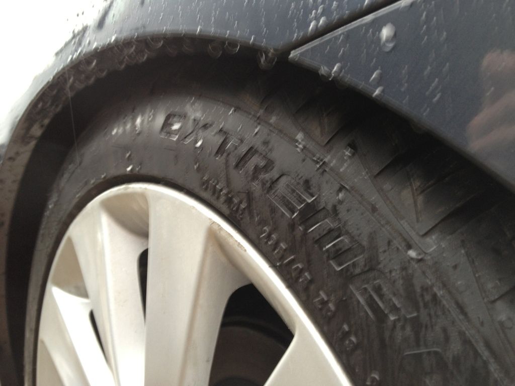

Finally got the rear fenders rolled, today, and they came out perfect
I'll be putting my 20mm/25mm H&R TRAK+ spacers on tomorrow giving these 18x8 +55 8G wheels a +35/+30 offset for a more flush look. Rolling the fenders freed up at least another 15mm than before.
Before:
During:
After:
I have so much more room now, I'm geeked

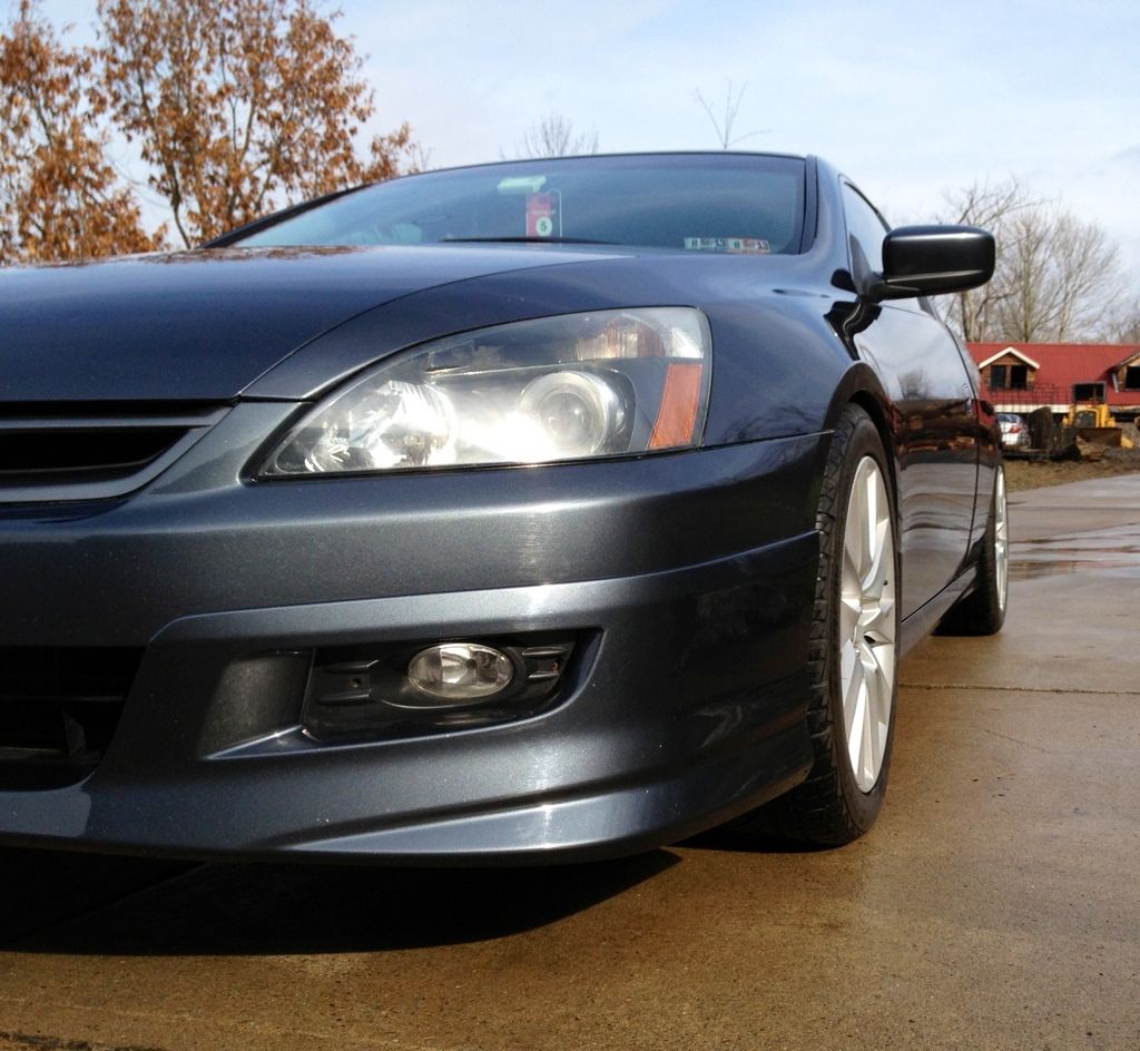

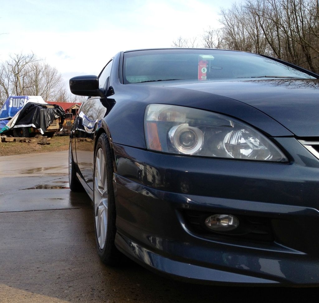

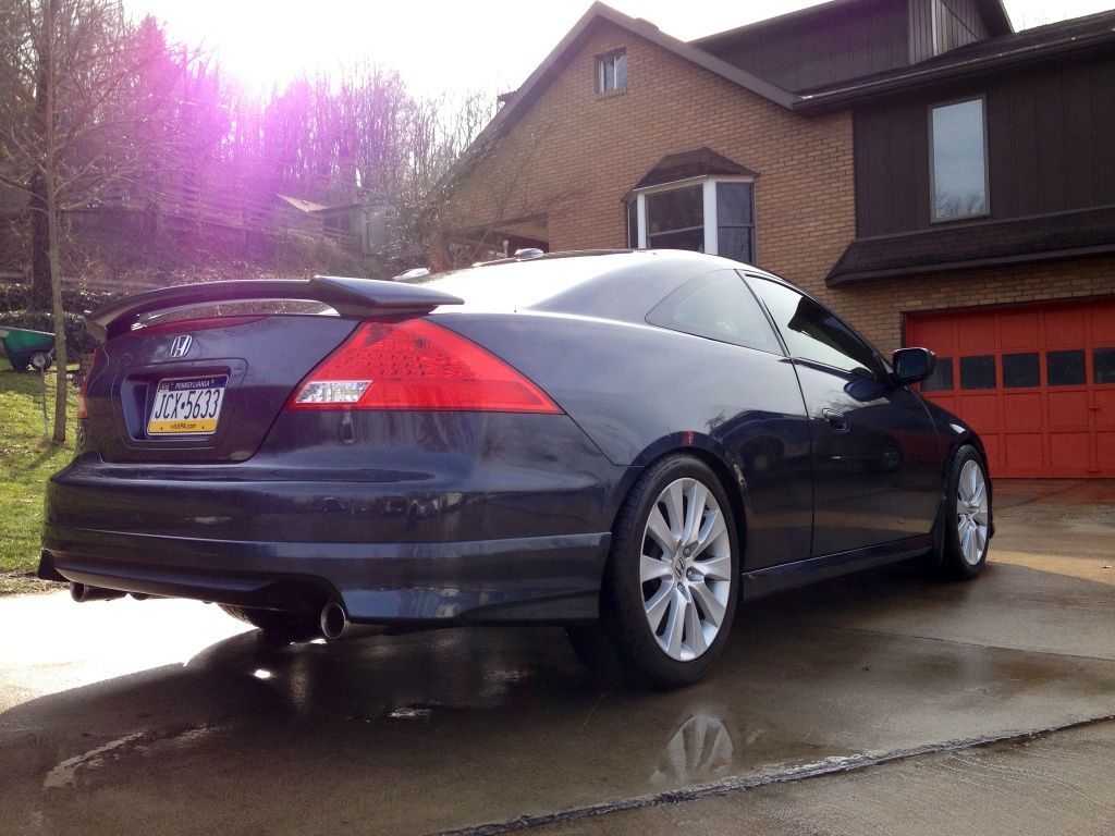

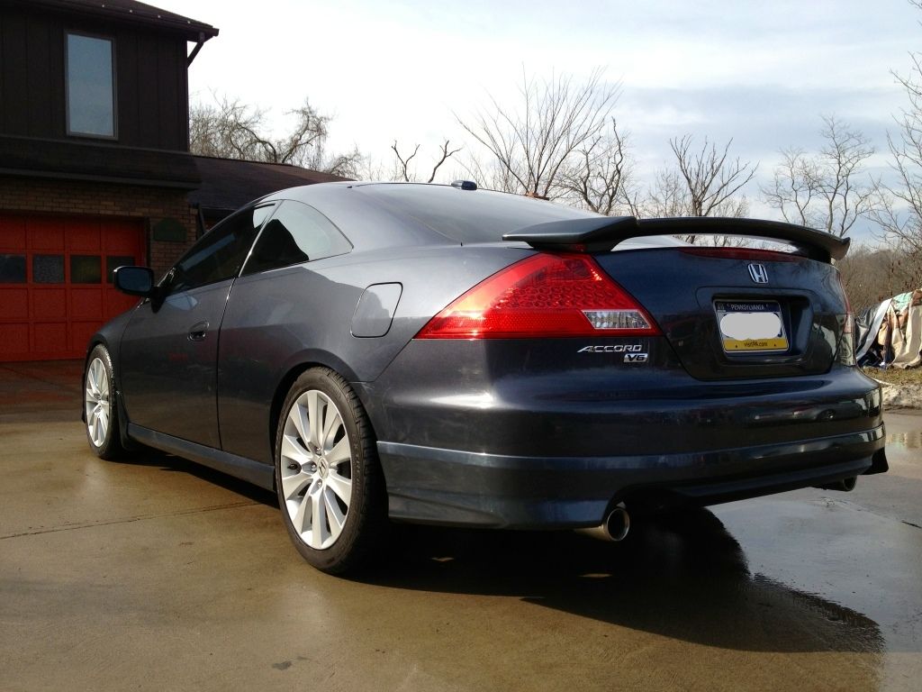

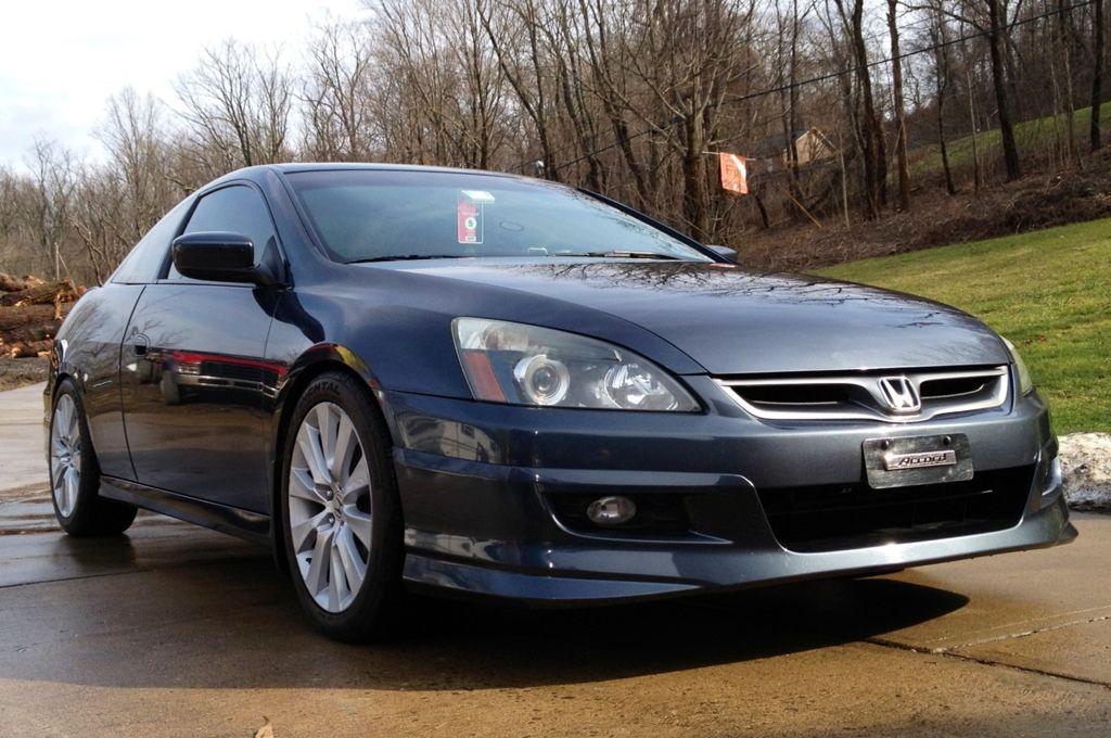

January 29, 2013, 04:30:32 PM »
So today I got my H&R TRAK+ spacers back on! I absolutely love the outcome! I'm running 20mm front / 25mm rear to give the 18x8 10-spokes a +35/+30 offset
However, I did notice on my way to class today that my rear was rubbing a little bit, so tomorrow Ryan & I are going to pull the fenders (the slightest bit) to clear
PIX TIME!
Ultra-Sexah!

January 29, 2013, 04:46:27 PM »
Quote from: DreaminAccord on January 29, 2013, 04:30:32 PM
What are you dropped on? If you can adjust your compression separately from your rebound, I would increase stiffness on your compression first. If not or that doesn't do enough to fix it, then I would add a tad bit of negative camber. You shouldn't need much. Adding -0.25 should do it..
You shouldn't see any negative effect of adding negative camber until you add an extreme amount of negative camber.
I would personally play with the alignment before doing any fender pulling.
Reply #6069 on:
January 29, 2013, 04:48:27 PM »
He's on Basics. Like I told him on one of the other forums he's whoring these pics on, the little bit of drop he plans on doing tomorrow should take care of adding a little bit of camber.
DreaminAccord
Posts: 293
I <3 My Honda
Reply #6070 on:
January 29, 2013, 04:53:07 PM »
haha I'm slutting 'em out, not whoring...whores get paid
I usually post the same thread on each forum b/c not each forum has the same users
and yea alpha I agree with you - I'm running -1.2 camber in the rear on both sides right now. -0.5 to -1.5 is OEM spec and probably down to -3 camber is still acceptable for not-so-bad tire wear. Anything more negative than that and you better have back up tires lol I'm going to drop her more in the morning and see how it sits.
D'you think I'd achieve a natural -0.25 more neg camber by doing about another 3/4-1" drop?
Last Edit: January 29, 2013, 05:16:40 PM by DreaminAccord
Ben
1st Honda!
Graphite Gray / Black Leather
Reply #6071 on:
January 29, 2013, 06:32:58 PM »
If you are going 1" lower, you may need to add more negative camber. You'll naturally get more negative camber by going lower; but how much is a question I can't answer. I was guesstimating adding -0.25 from your current ride height. When you go lower, you may naturally go from -1.2 to -1.5, but you may need to up it towards -2.0 for the tire to tuck without rubbing.
Are you planning to lower 1" from ground to car? or 1" on the thread collar?
DreaminAccord
Posts: 293
I <3 My Honda
Reply #6072 on:
January 29, 2013, 07:22:29 PM »
1" in ride height (ground to fender). When I originally dropped from stock 27" rear to 26" I got a 4 wheel align done (have unlimited for 3 years
) and Christian said I was at -3 camber. He drives a slammed Civic Si so I love & trust him (only) in doing my alignments as he's another Honda enthusiast plus understands what it's like having a lowered car. I told him I wanted to stay within OEM spec so he set the rear camber at -1.2 on both sides and toe is 0.10* L / 0.00* R - OEM spec for toe is 0.00*-0.15* for each side, total toe 0.00*-0.30*

January 29, 2013, 07:26:36 PM »
Was that a 350z in the reflection?
Reply #6074 on:
January 29, 2013, 07:51:26 PM »
No, it's an F-350 super duty. Lol
