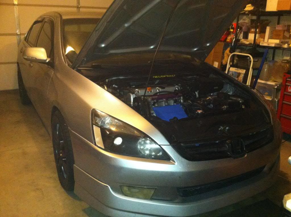

I bolted the cooler and sc back on and bled the aftercooler system. I also replaced the power steering feed hose from the reservoir. It seems the hose I was using was a little too large and too long and had some damage from rubbing up against something in my engine bay, so it was leaking fluid. I'm just waiting on the sealant to cure overnight so I can start it up and bleed the power steering system.

Beauty sittin in the garage...

What's the blue object in there?

In where?

I think he means in your engine bay, Tim.

That's blue painters tape that I have covering the intake manifold. Whenever I take the SC off, I clean out the intake manifold, stuff shop towels in the runners, then cover the huge opening on the plenum with tape so nothing can get in.
