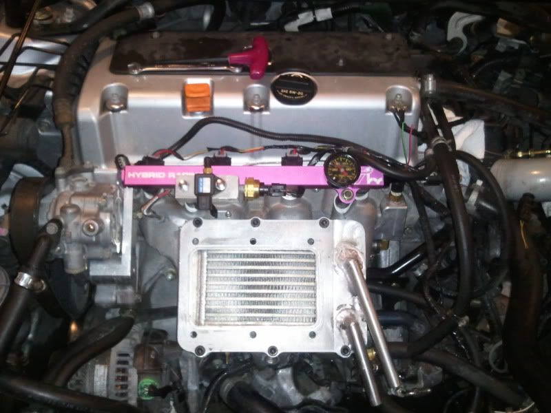

I did this today.
I ended up with this when I decided to call it a night. I should have everything finished up by tomorrow.
To give a brief recap of what I have done today. I started off by replacing my front ps door lock actuator. After that was done, I moved on to the engine bay. I wanted to do 3 things today. Put on my new fuel rail, install my 2nd ect sensor, and put on my new aftercooler. On to the problems. To put on the 2nd ect sensor, I need to remove the intake manifold. To remove the intake manifold, I have to take the supercharger off. There was a bolt that was impossible to get off because the aftercooler was in the way, and the head was rounded, so I had to grind that off. Then after the SC was off, I had to take off the PS pump and auto tensioner. Then I had to fight with another bolt on the IM that was hard to get to because the Hasport IM adapter was in the way. After getting that all off, I was finally able to start disassembling the aftercooler from the SC and do a little bit of work on the TB and the SC inlet that I have been putting off. I did a dry fit of the new aftercooler and the SC to make sure there weren't any fitment issues, and that's where I stopped.
