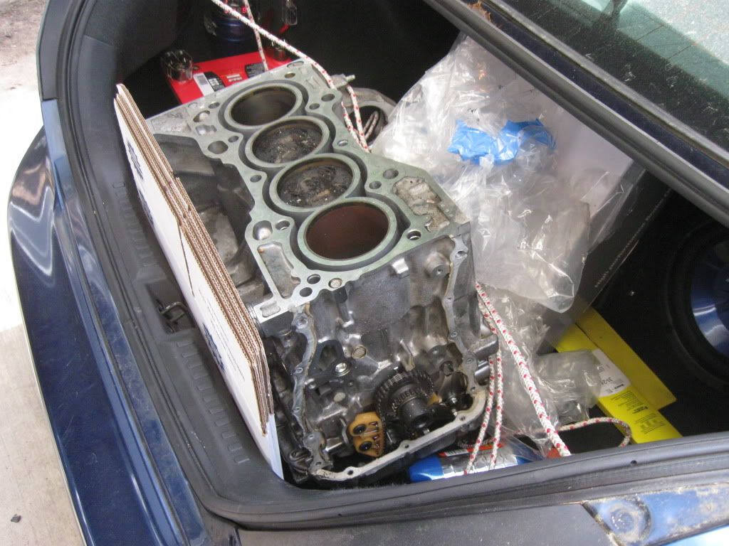

so what exactly was being done? complete rebuild, forged internals? how much did it run you?
Reply #1546 on:
May 22, 2009, 08:52:16 AM »
obviously the headswap was incorporated and was ported as well as a full gasket replacement and slight block boring for type A OEM TSX pistons, so this should be good for about 11.2 cr either way I got the k20a2 oil pump and am struggling to get that chain at the moment to complete the build :-/

May 22, 2009, 07:29:18 PM »
TSX Pistons Installed and looking beautiful
Nearly Fully Assembled
Hope to have it take its first breath tomorrow night! Sweeeet!
