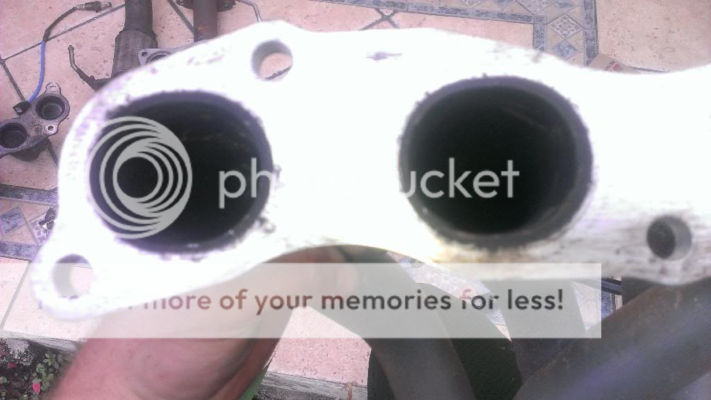

Over the winter break i installed a used DC Header i got for a good deal. It was missing some gaskets and stuff but i was able to find what i needed. I didnt buy an O2 sensor extender cable to make it reach instead i just cut the wires and used my old Secondary O2 sensor that i had replaced a few months back to make the wires longer. I soldered them and shrink wrapped them so everything is legit.
I really wasn't expecting much of a change but to my surprise there was change. Im not sure if it was for the good though. Before the header, when i was going say about 40 mph and i floored it,  the car would do a little jump forward and take off. Now with the header that little jump is gone at 40mph however i noticed that now it does it when i floor it from a lower speed like from a stop up to 20mph. Im guessing this is an increase in low end torque?
The difference in the inlets of the oem and DC Sports header.

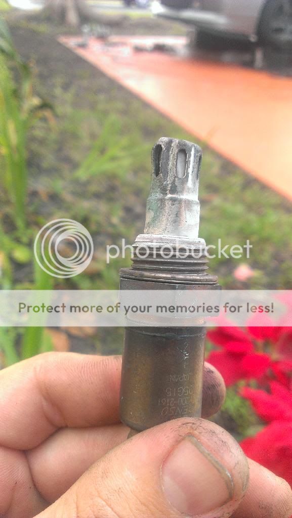

Another question i have, Is this normal? This is the Primary O2 sensor, i am getting no CELs about this sensor what it looks fucked up.
« Reply #172 on: January 07, 2014, 03:23:07 PM »
Yup. That looks pretty fucked up. If you notice a decrease in fuel economy, you'll need to replace it. You should get an O2 extender so you don't have to solder new wires when you need to replace it.
