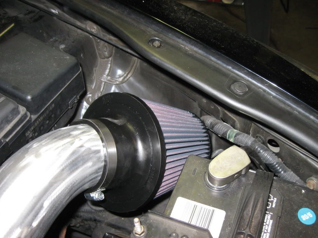

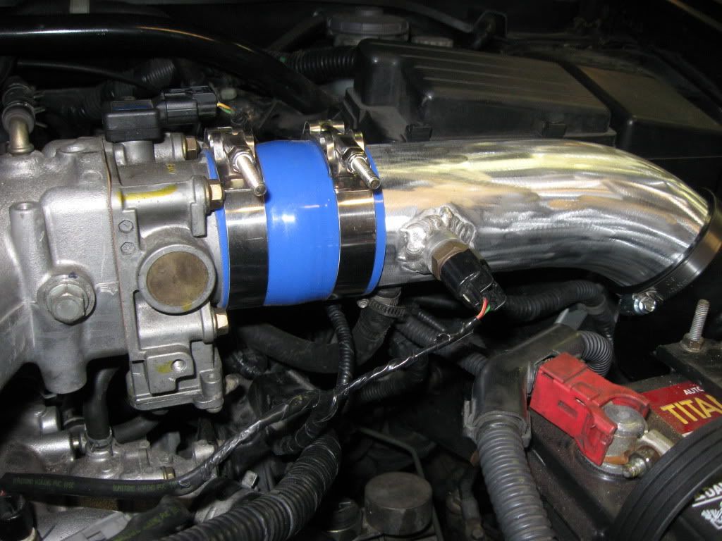

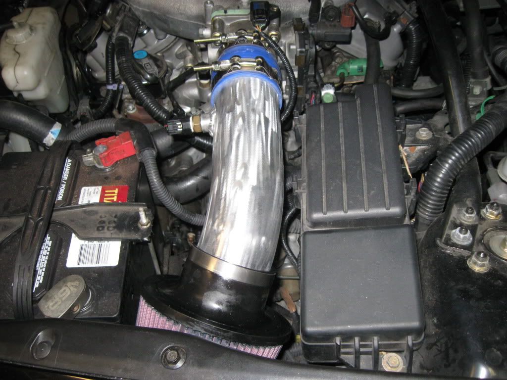

I figured it was about time for me to make one of these since there really doesn't seem to be a option out there. I stratched it out to put the filter into the opening for the stock air box so it will still draw mostly cold air. Welded in and threaded a bung for the Intake Temp Sensor and am using silicon couplers and stinless T-Bolt clamps. It also has a 1/2" port in the bottom for the breater line. It is 3" diameter and currently I am using a K&N RE-0930 cone filter alothough pretty much any 3" cone could be used. What do you guys think?

Looks good Paul. I like the threaded AIT bung.

If I'm not mistaken, I thought these intakes are not good for the car because they bring in hot/warmer air from the engine bay than the cooler air that is in the bumper. Warmer air is less dense than colder air so it has less O2 in it, thus less power.

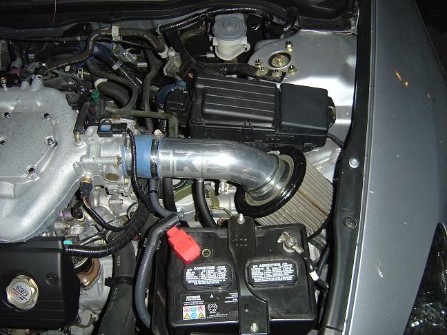

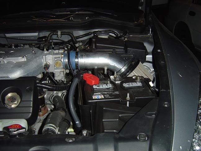

looks like my K&N sri but as you know its only 2.5" i wouldnt mind bigger size pipe or V2

That's whay I have the filter on the other side of the battery, as long as you are moving forward you will be getting cold air up thru where the stock air box normally goes.
