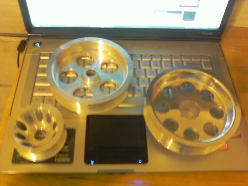

Okay, so this persistent squeeling noise when the a/c or defrosters are engaged started to show up within the last month. The engine has had a minor squeeling noise (even with the a/c off) for a while, but now it's getting progressively worse and seems to get louder when the steering wheel gets turned. Once the a/c fans kick on, this noise appears, regardless of if I'm idle or driving. At first I thought it was the belt, but it can't be. Some recommendations have pointed to the compressor unit crapping out, which seems to be a $400 part. What do ya'll think? Here's some current engine specs that might help out:
2003 Accord i4, automatic, daily driven, has the Unorthodox Racing underdrive pulleys for about 10k miles and a new oem belt installed at the same time (maybe I shoulda got the smaller Gates one, but the belt tensioner indicator arrow seems within spec, right??), only about 55k miles on the car.

Bad tensioner. That will be $49.99 for me to diagnose it Dave. Haha. It seems like the tensioner is binding up right when the A/C engages. When the A/C compressor engages, it puts more inertia on the serpentine belt which then cause that noise. Did you use the right size belt? Having a wrong size belt can cause tensioner clap. Usually, a longer belt will cause a squeel on maunal adjusted drive belts, but auto adjuster belts have a little more slack. If the belt is even a tad bit off within that spec, it will cause a tensioner clap (as I call it). The tensioner clap is when the belt puts force on the tensioner to just to get it out of the specified range that it needs to be in.
Try a smaller belt to see if that helps. If the problem persist, replace the tensioner and hope the problem goes away. I hope that helps you out. I heard similar noises like the one you posted, and it came down to a bad tensioner.

hey im having the same noise problem...i just installed my UR underdrive pulleys and i been noticed the same kind of weird noises it seems to be stronger when the AC compressor turns on..i think the pulleys have something to do with it

this are the ones i have and they some times makes that noise when the engine is been running for a while and the motor is hot..They are under drive pulleys use the OEM belt since it is compensated witht he p/s.

I have that same noise and it started after the install of my Ralco Pulleys.

Thien, how sure are you that it's the belt, or worse, the tensioner? It seems like most people in this thread are reporting that after installing some kind of aftermarket pulleys, they're getting odd noises like this. It's a shame, because back when the UR pulleys were released, a lot of people told me that the oem belt would be fine, so I grabbed a new one from Honda and called it a day. This seems to be a false assumption now. I can try to go out and find the properly sized Gates belt that UR recommended (for the RSX or TSX pulley kit... can't remember exactly at the moment), but I wanna be certain that it'll be a fix-all, unless you think that having the oem belt for the past year may have done permanent damage to the tensioner.
