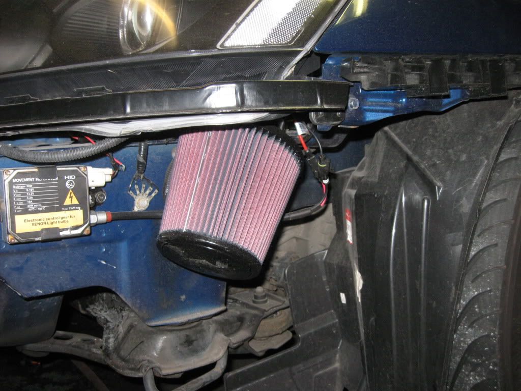

Everything is hooked up and running, but can't take it out yet, still need a 45D silicone elbow for the filter (due in tomorrow) and some fittings for the FPR.

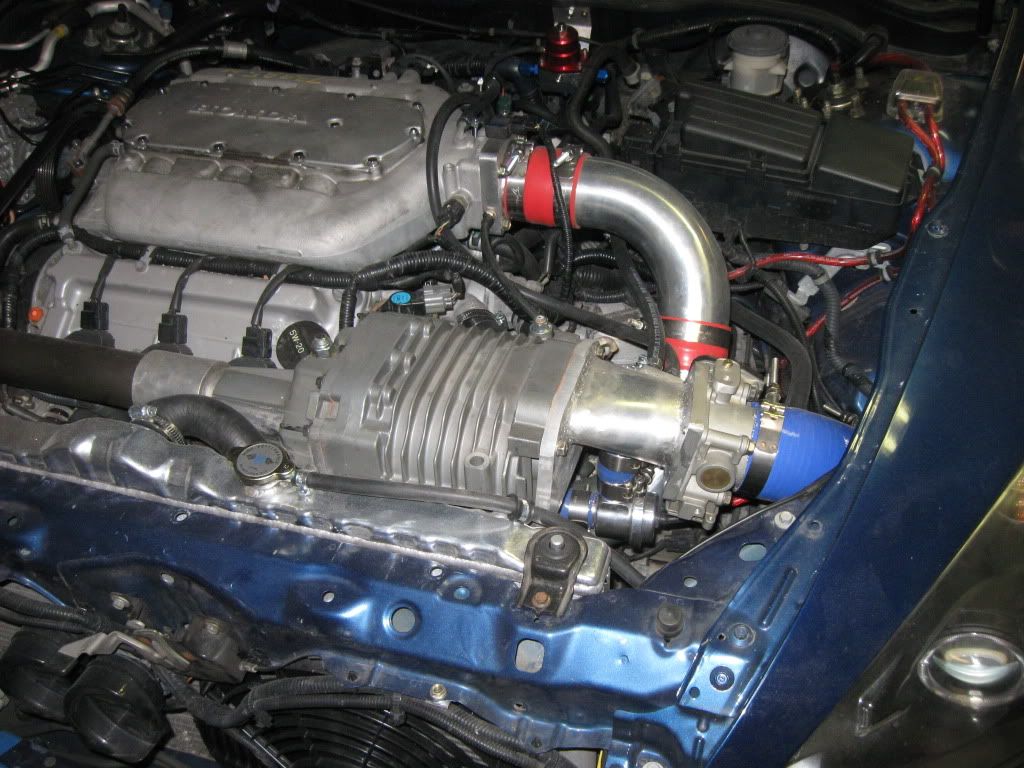

BIG UPDATE......
She runs......
Ok here are some pics of the intake, re-worked upper rad hose (will be making up anpother and getting it quoted for production as a one piece silicone along with the lower).
Now for the biggie, granted there is still a shiz load to be done, but took her out for a quick spin around the block and for those who know the area, ended up on RT15 between battlefield and edwards fery, put about 1/2 throttle in her and immediatly got 5psi at 2000-2500 RPM, of course the AFR was dangerous since no tuning has been done yet and the FPR is not hooked up yet (will be done Friday when I get back from Anavesary Vacay), this thing wants to boost and quick.....

damm looks great this is what my v6 is missing lol .That looks like a tight squeeze with the radiator house do you consider upgrading to a stronger silicone type?

Obviously you don't read, LOL, I posted that this is a prototype made from two different hoses and will be sending a assembled one out for quotes to have them made from silicone.
