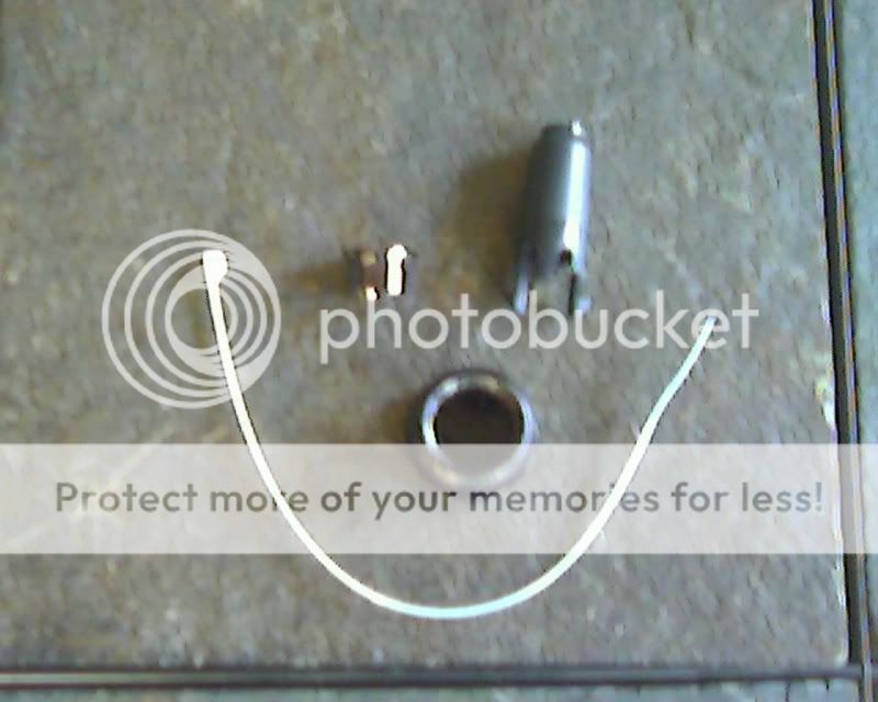

Make sure you have all of the accesories that should come with the knob . I called the store (Showcase Honda/www.hondapartsunlimited.com ) to make sure that all parts that are illustrated on thier site are included . They were . I would suggest you do the same just to be on the safe side . The parts mentioned are - 1 cable tie ,1 14mm reataining bolt ,1 shift boot grommet , 1 shift boot grommet extension and of course the actual shift knob (not pictured)

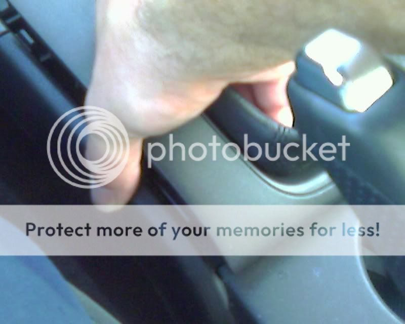

1)Unclip shift boot from knob . I did this by grabbing the shift boot grommet at the base of the shifter and pulling down . If you notice my fingers are cadi-corner/opposing stiches in boot from each other . I find this way to be easiest .

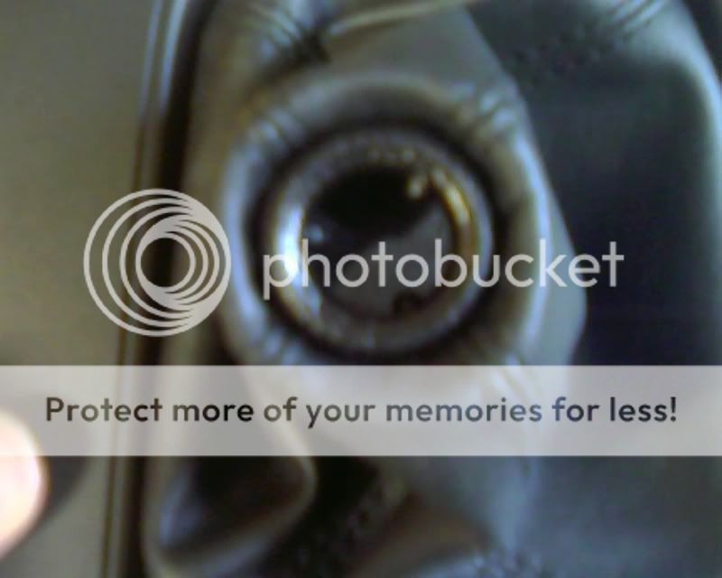

3) After you remove your factory/original knob you should have this ....

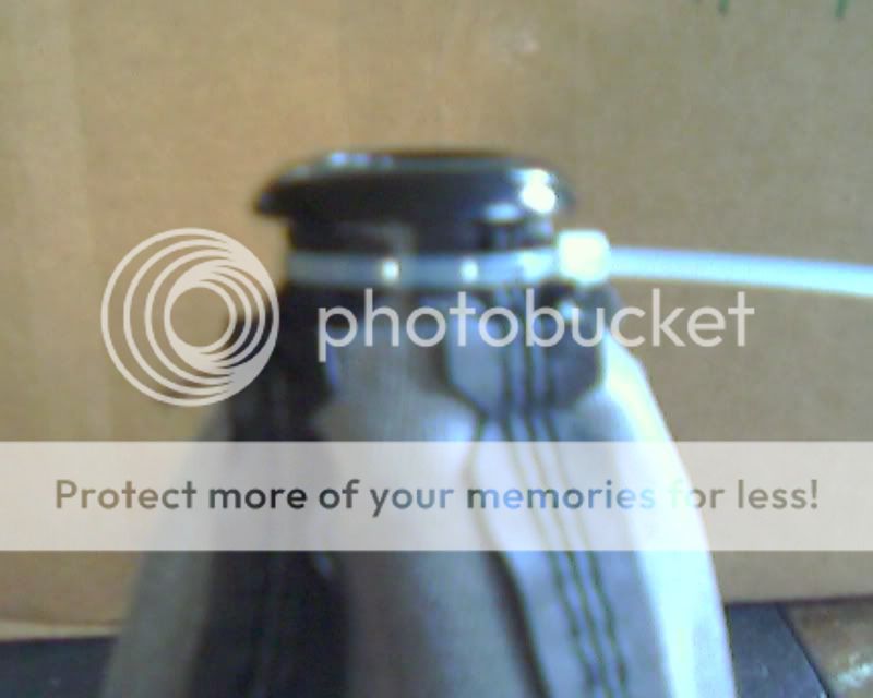

7) Next take the shift boot assembly inside. There is a cable tie that attaches the shift boot to the shift grommet . Use A SMALL pair of snips or scissors to cut this . If you use a knife be carefull not to cut the actual shift boot
8) Turn the shift boot assembly inside-out
9) Remove shift boot grommet by pulling straight up

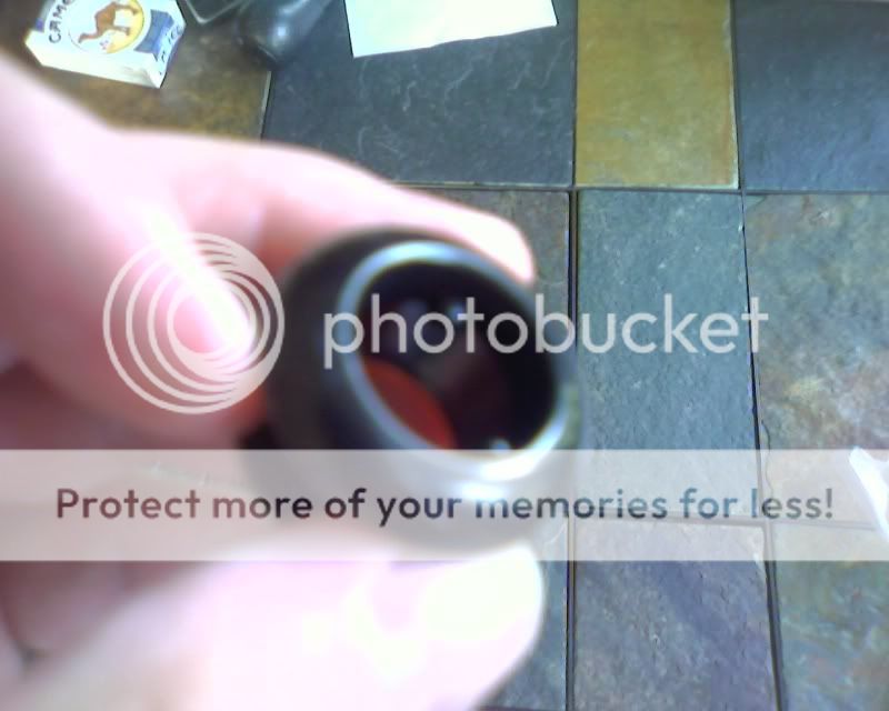

10)Take a look at the shift boot grommet supplied with the knob . Notice there is a textured side and a smooth side/sunny side . You insert the textured side into the boot face down/torward the inside of the car
11)After that use the cable tie to attach the supplied shift boot grommet,sunny side up . Cut off excess with snips .

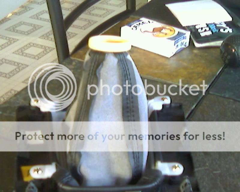

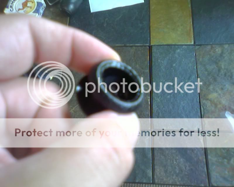

12)Push the shift boot assembly back through to the original position and this is what you should have

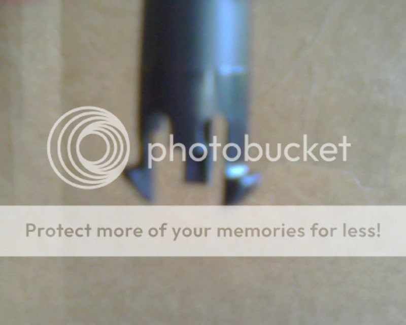

In the picture above notice the 3 prongs inside the grommet . Those 3 prongs slide into the grooves in the grommet extension

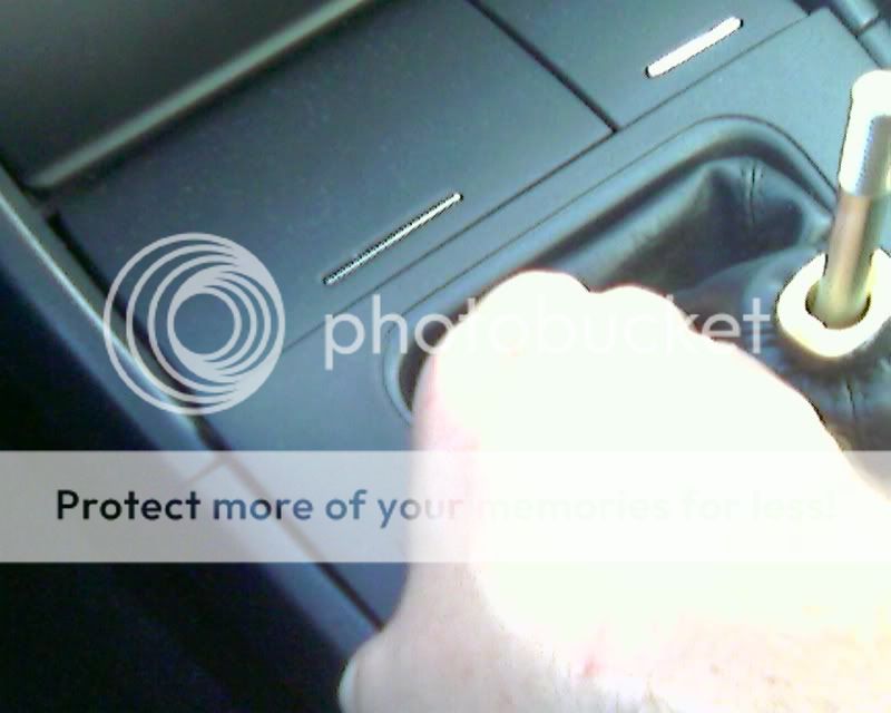

13)Re-install shift boot assembly .Do this reverse of how it was taken out by just pressing down on the bezel at all four corners of the bezel
14) Install grommet extension . This probably should be done before you re-install the shift boot but I wanted to see how it looked without the extension .
15) Screw on the retaining bolt
16) Screw on the shift knob and tighten the retaining bolt against the shift knob and you are done . I actually went a little stupid on it and covered the inside of the wrench with masking tape to make sure the bolt didn't get rounded off when I tightened it

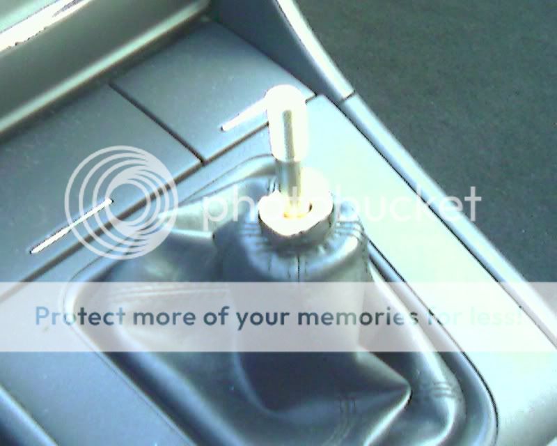

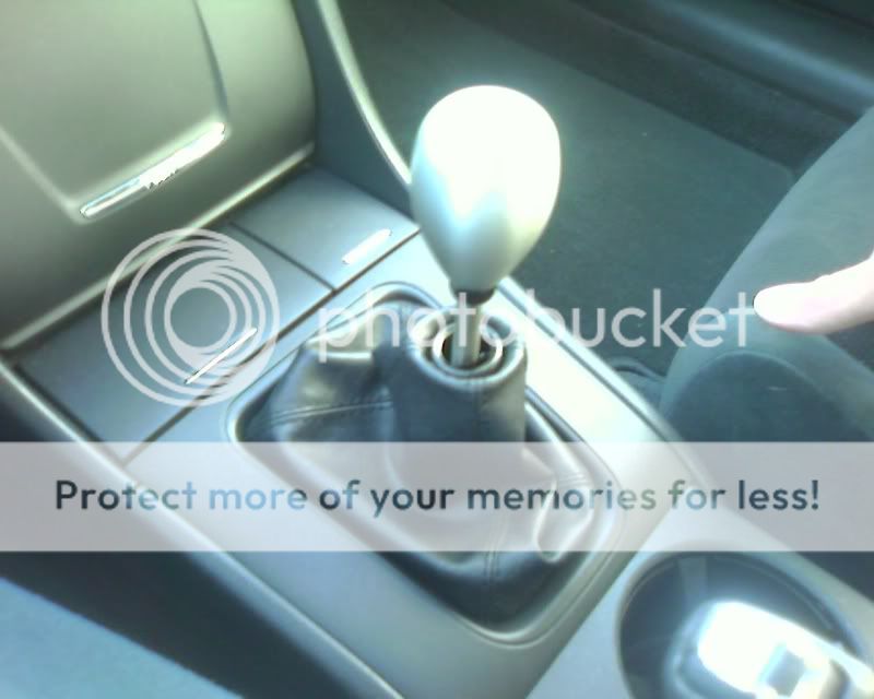

Finished product without the extension
And with the extension

u installed that little black tube peice upside down (the black tube that sits under the shifter knob). the knob should be flush with that ring. i did it like u did. then i looked at it twice and said what?!?!
u installed that piece upside down. the boot should sit flush with the knob.
to do this u must unclip the boot again. that lilttle black piece u take out form the top. then u take off the boot. flip that lilttle black piece upside down so that those three "teeth" i guess u can call it that. face upwords. THEN u put ur boot on top of that. then press down on the ring at the top of the boot until it clicks onto this teeth. and then put on the nut and attach the knob again. i hope this helps. i dont have pictures of the install but i have pics of the final product
