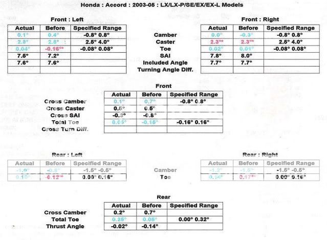

Here is a picture I scanned of my recent alignment. This is to show you where you alignment needs to be. Of course you can mess around with camber here and there for better cornering. I hope this answers a lot of questions.

These are my two previous alignment results. The Firestone tech told me the front right caster can't be changed and rear camber balances out so I would have no problems. Thien, it's interesting that you can get all your numbers to Honda specs if what my FS tech said was true. Care to fill me in on why this is so and why my specs will be okay? Thanks!
The first one was on January 14th, 2009.
The second on was done earlier this morning. For what it's worth they used the wrong specs as the DX numbers are different than the EX/LX. I also have no idea how they get the 0.08 degree tolerance for toe after I tried a zillion calculations...
EDIT: I test drove it on the hwy and now it's drifting right... WTF

Caster is not adjustable. Do you have a rear camber kit? If so, the technician should've adjusted to make them equal. Every alignment I do, I always try to get it closes to factory specifications. Each adjustment has a tolerance. The tolerance spec is different for each car. The tolerance on your front toe is a total of 0.16. From 0, which is Honda specifications, you have a tolerance from -0.08 to 0.08. I would go back and advise them that your car still drifts and or pulls right. Have them recheck your alignment, and tell them its an EX/LX.

thanks Thien, I don't know if for my specs if DX or LX/EX mattered since they were still within both model's specs. anyway, the alignment this morning went much better and the accord doesn't drift anymore. I don't know why Firestone would assume I had a DX, or for that matter how my car drifted horribly to the right...
