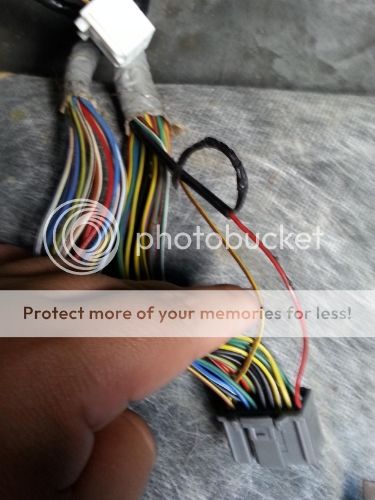

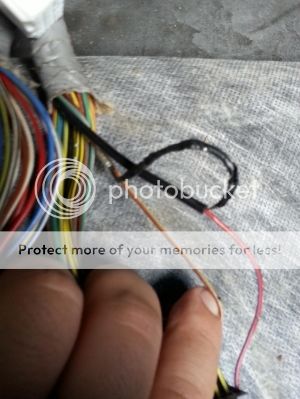

I've followed as much of the wiring as I could, and this seems to be the only thing out of place at the moment. Is this normal or could this be something the shop did..... that is a fat black and purple stripped wire converts to the red/blue which is the knock sensor and its bridged to what I think is "ground circuit" (brown/yellow)

damn no one? well from what it seems that wire is supposed to be there, I took off the black tube that covers the wires and it runs all the way out into the engine where its been untouched besides that bridge, so i'm starting to guess its oem. I'm more inclined to think its the extra ground wires on the injectors the shop wired up... all he did was add another cable on each injector on the pre existing ground and connect them right before where the oem injector grounds out on the Intake manifold...
Edit...
took them all off, no more fuse blow... but still no full turn on
