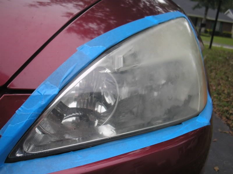

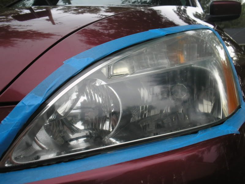

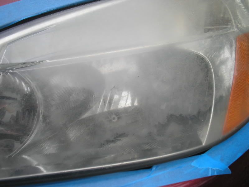

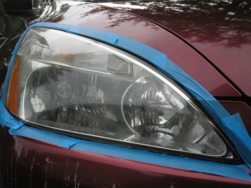

This is definitely worth the effort. Took maybe 10 minutes per side. I'll be taking it out after dark to see how much better I can see. I'm sad to actually see how bad I let it get. It's still not where I would like it to be but anything is better than what it was before. I'll be doing my car next week. More pics of that to come. Enjoy
Before
After
And a few more for good measure

What'd you use?

Headlight Restore Kit from advance auto parts. Basically came with two grit types of sandpaper and some almost gel type liquid to polish it up with.

looks good but you will get better results if you buy sand paper 800,1000, 1200, 2000 grid and some plastex will do a way better job.

I might do this, since I plan on keeping her car. I noticed the haze gone but there are some scratches that the liquid didn't fill in
