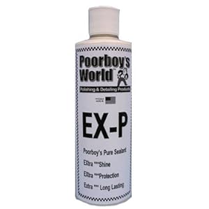

Here are the two I would recommend. The first one is best if you plan to use the sealant on the car as well. Coupon code EarlyLabor gets you 10% off and free shipping but ends today...
http://www.detailedimage.com/Poorboys-World-M1/EX-Sealant-w-Carnauba-P26/16-oz-S1/
http://www.detailedimage.com/Poorboys-World-M1/EX-P-Sealant-P27/16-oz-S1/
