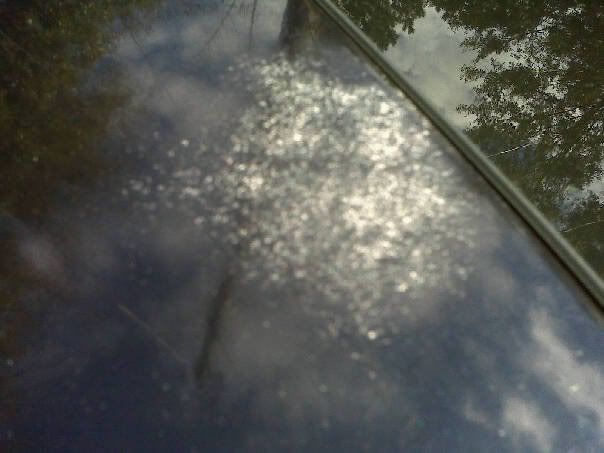

My clear coat is coming off my roof. Right now it's a tad smaller than my fist. How can I correct this? Need some steps from you detail guys out there. Can I just throw on some buffing compound and call it a day, or is it a multistep process? It's a big eye sore since I'm trying to sell my car, plus, of course it's just going to get worse. I need to slow it down, completely fix it, or cover it up. I dont care. Just want to fix it. Pics of the damage to come later. Any help would be much appreciated.

There is no such thing as just quickly fixing this issue. If the clear coat is failing, that's it, game over. Once the paint system is compromised like this, there are not many great options. The options as I see it are as follows:
• Wet sand and clear the entire roof, making sure to really get any rough edges where the clear is coming up now.
• Wet sand just the area and clear just that area, using a heavy compound, polish afterwards to attempt to blend it in
• Take an aggressive compound and buffing pad combination to polish the painted area around the clear coat failure and then the rest of the roof to make it blend until you sell the car, although this will most likely look good for a very short period of time.
• Ignore it, knock a few hundred off the sale of the car and be done with it

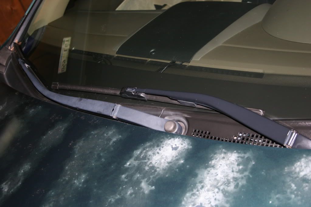

I can only find one picture on my computer of my damage. In May 07, there was a dime sized spot on the hood. The car is garaged and well taken care of. Here is the picture. I took it for the Back to black, reason for the different color wiper arms.
All that to show, do anything you can to prevent the spread. That pretty much covers the entire hood. I am about to get it fixed, I am just trying to decide which shop to use.

Now that I can see the actual damage with the picture, if it were me and I would be selling the car, I would probably just forgo any sort of sanding and use just a polish on that area to make it blend in and then cover with some wax or sealant. It would last long enough for the sale to probably go through. Being as you are not going to probably purchase higher end products and need to get something over the counter, I would say look at purchasing some Meguiars Ultimate Polish. Afterwards, I would coat with either Mequiars NXT 2.0 sealant. Let it cure for about 10 minutes and put two more coats of the NXT wax. Again, this is going to simply mask the problem. The area will get worse and not go away over time, but it would look nice for a long enough period of time to sell the car.
There are better non-OTC products for the job, but probably not worth the money to invest into, without having the right equipment to use it with.
