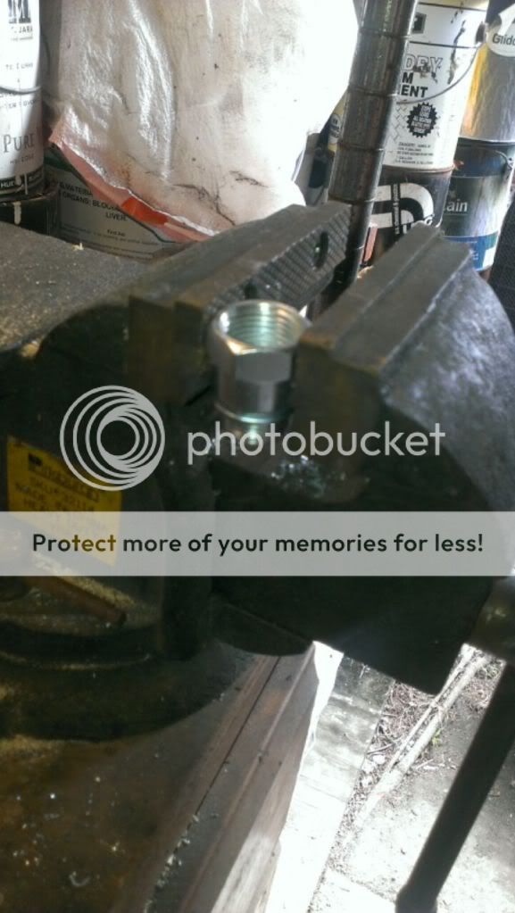

Two:
Place one of the non-fouler in a vise. If you don't have a vise ask a buddy to hold it in place with a pair of pliers.
Three:
Next, You will need to expand the hole in one of them to 1/2 inch in diameter so that the O2 sensor can fit inside and screw in. The other one will be left alone.
Be careful to not mess up the threads on the sides of the non-fouler. Keep the drill bit as straight as possible.
