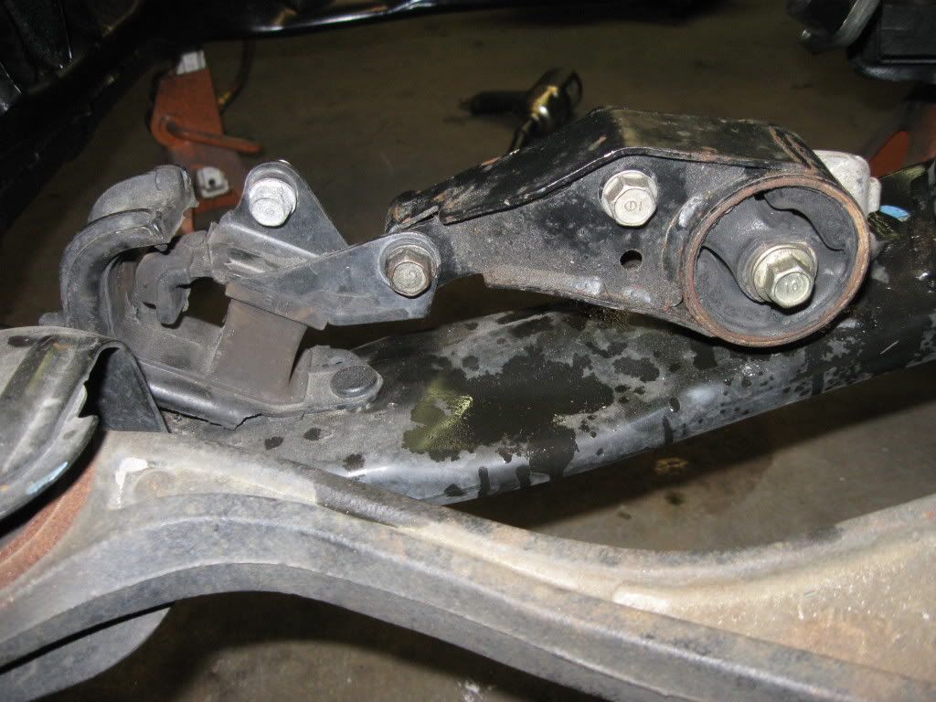

I recently got in a 05 TL-S 6sp tranny for a swap I am doing and it had the lower mount still attached, after looking at it I saw that it would be a nice upgrade for our 7th gens so here it is and how to do it, in this case it was done with the K-Frame out of the car but could also be done easily with the frame still in the vehicle by just removing the 2 bolts that hold the passenger side mount in so you can rock the engine on the front and rear mounts.
The new mount installed.
The mount itself is a direct bolt on to the K-Frame you will need the following parts.
50860-SEP-A12 RUBBER, RR. TRANSMISSION MOUNTING (MT)
This is the mount and the bracket and sells online for about $65

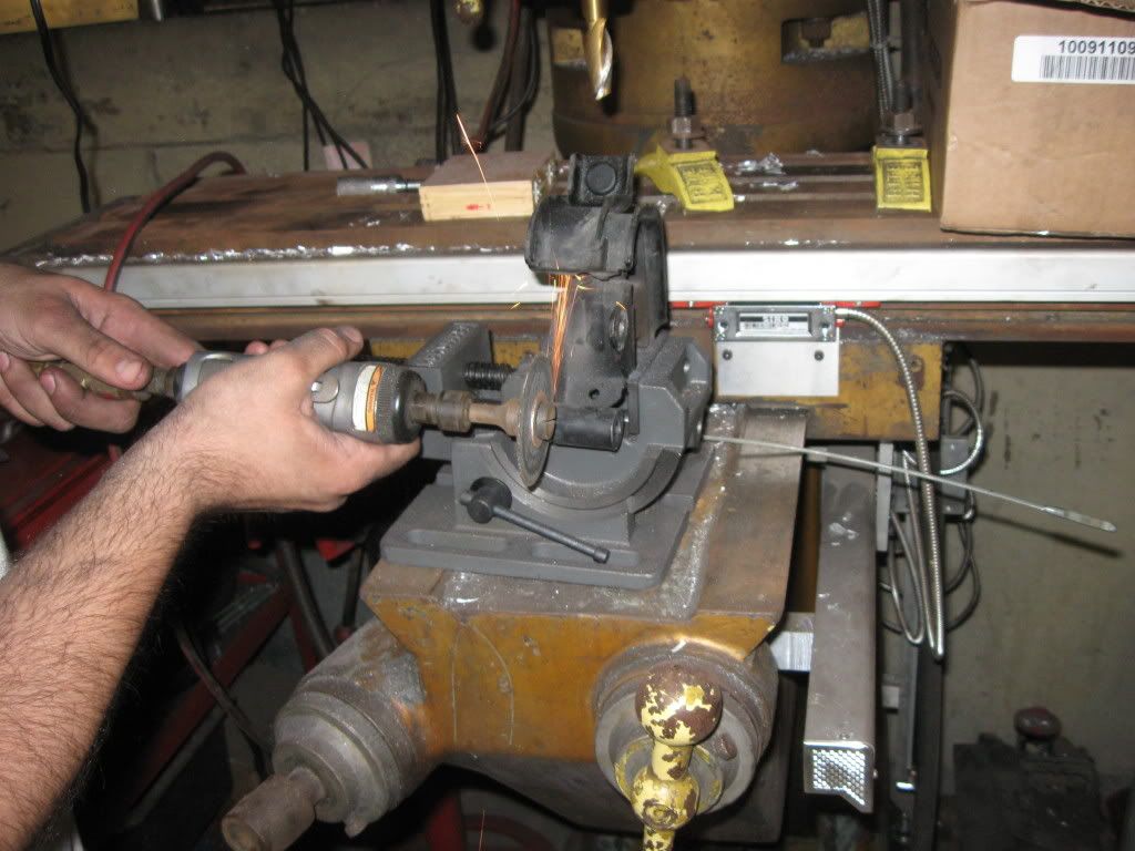

50850-SEP-A12 RUBBER, FR. TRANSMISSION MOUNTING

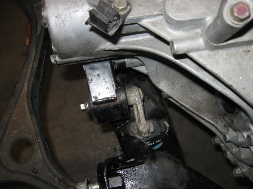

This is the other side of the mount and is $28, now you DO NOT have to buy this part if you are willing to do a little work, in the pics below you can see a spacer that is welded onto the mount on our cars, all you have to do is cut off the spacer and it will work with the TL-S mount.
Once you cut off the spacer or buy the front portion of the mount just bolt them up to the frame and then to the tranny, the TL-S mount will provide much better control over the drivers side than the "rubber band style mount that we normally have.
