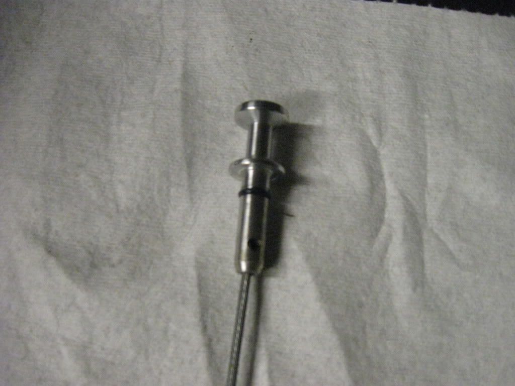

Quote from: "AV6NHBP6SPD"
why not just make those nobs and ship them like that?
maybe im thinking wrong but in this pic looks like dipstick wire is held by hex kinda screw
http://i203.photobucket.com/albums/aa22 ... ick004.jpg
im sure its not hard to set it to correct lenght
Can do that if you are up for it, just be sure to use RED locktite on the set screw.....
so it is just screw that holds the dipstick wire?
When you liberate the wire from the stock plastic, I used a dremel to split the plastic, the end of the wire is balled, the set screw goes in below the ball so it can not come out, the lock tight just ensures the screw does not move.
