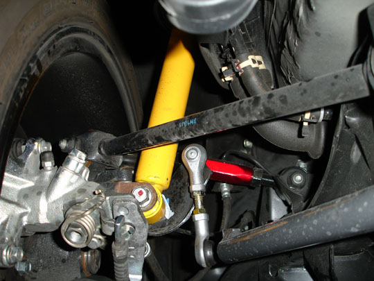

I ended up running these on my 24mm Progress bar. The ability to preload the tension really adds another dimension for dialing in oversteer or understeer for specific conditions. The bar is adjustable too.
