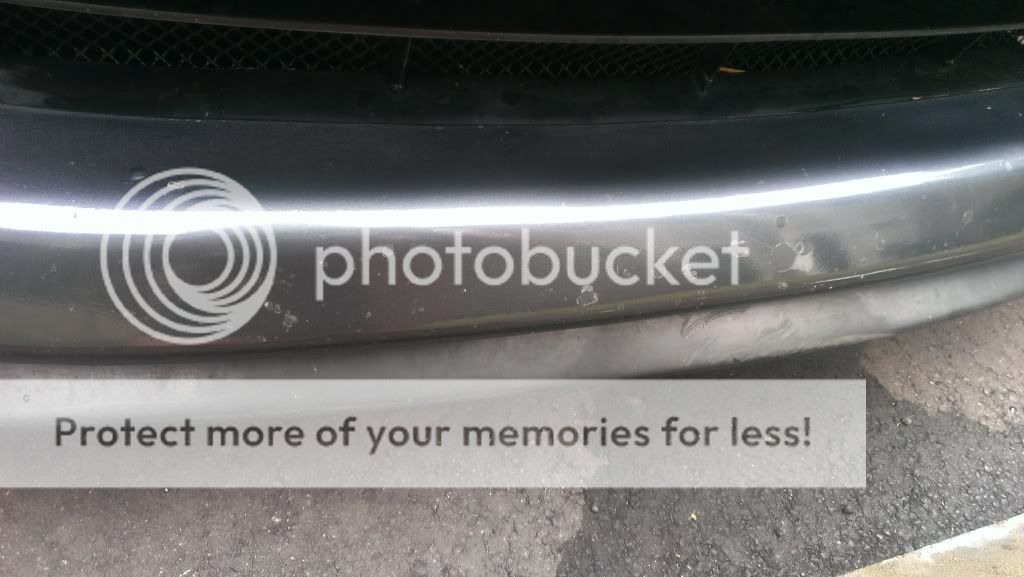

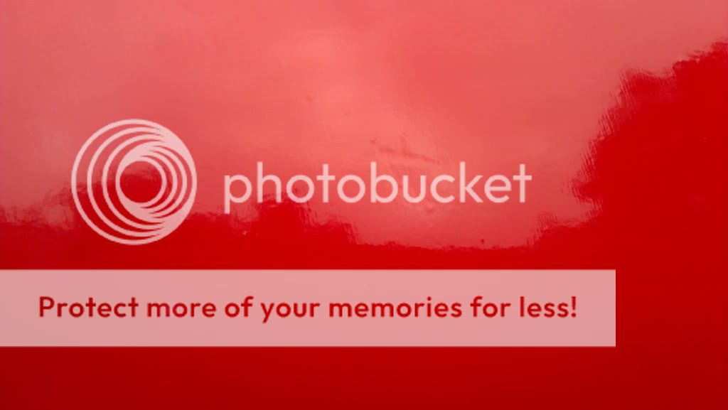

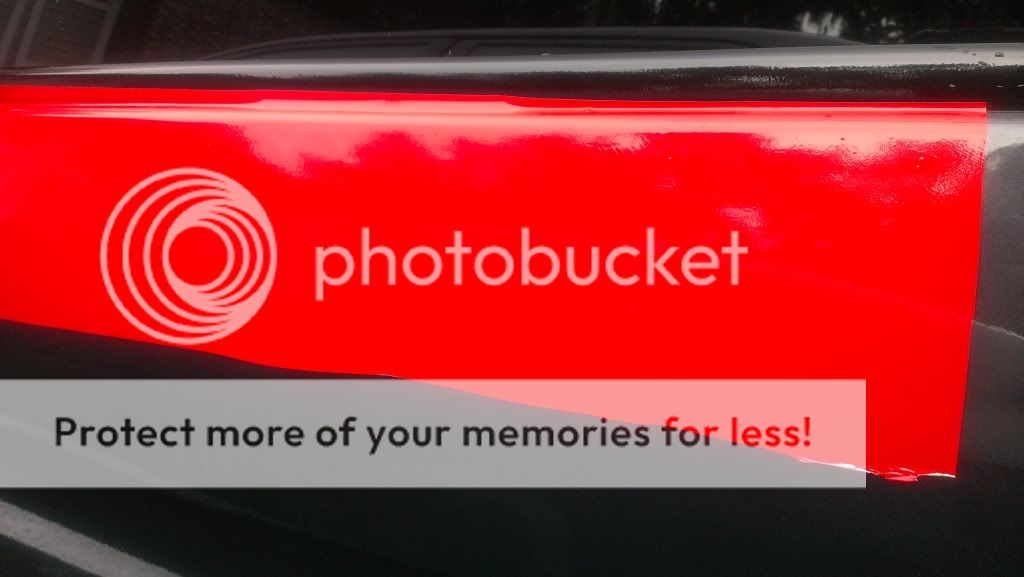

Tim is right, it wont. If the paint has any relief the vinyl will also take the shape of it. However, it will make things significantly less noticeable.
This is my rear driver door. See the three big scratches?
Same scratches covered with vinyl.
This is the biggest one.

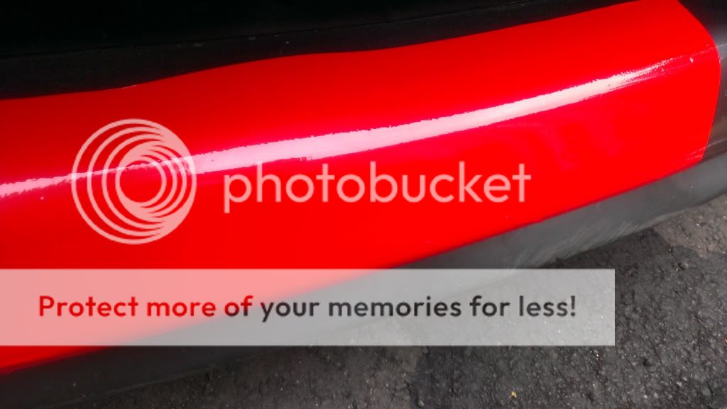

This is the front lip.
After the wrap.
If you look closely at it in person (couldnt capture it in the pictures) you can see the craters in the paint through the vinyl, but it still covers a lot of the color differences and such. For something like this it is recommended to sand those imperfections and smooth out the paint as much as possible.

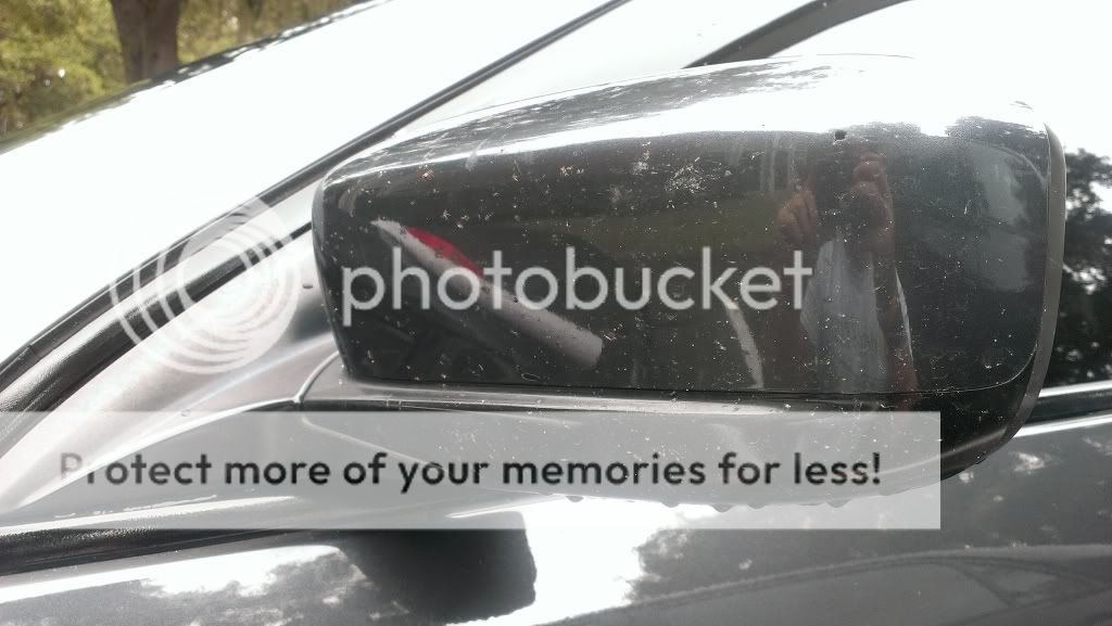

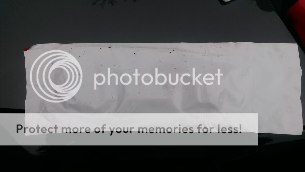

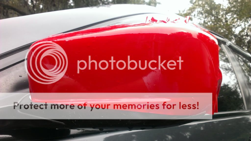

Buggy mirror.(i need to wash the car i know) And this is obviously not how you do it, the car needs to be washed, clayed, buffed and cleaned with alcohol before the vinyl is applied. I did this for informational purposes only.
After i removed the vinyl.
