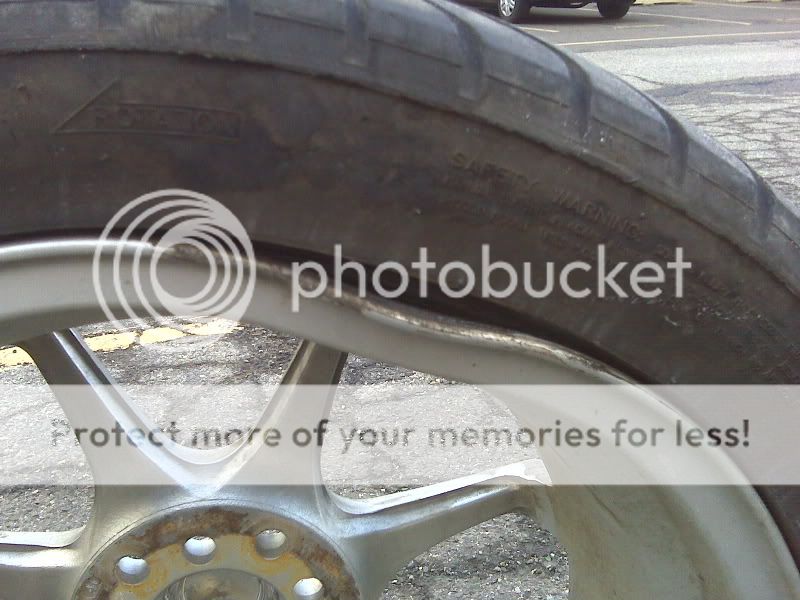

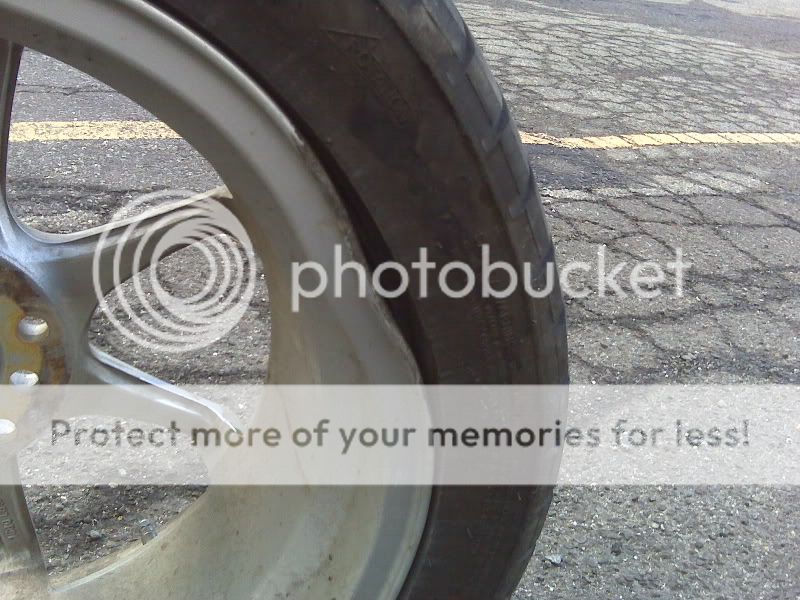

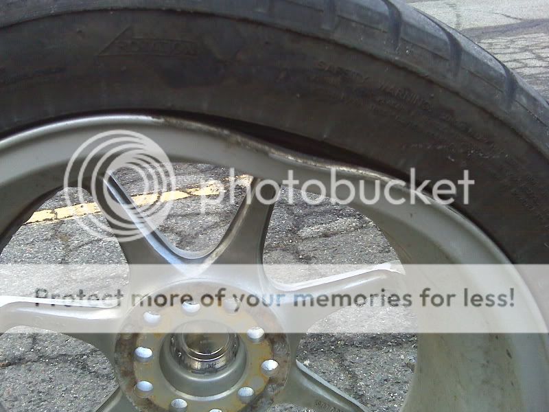

so heres the damage....
OUCH OUCH OUCH OUCH OUCH !
axel looks ok so dont all the other components in there... but i def need a second opinion
any clue anything like this can be fixed?
or should i just order a new rim tonight?
found $162 shipped...
Re: UBER Pothole = Tire/Wheel Problems
March 09, 2009, 08:36:34 PM »
Get a new rim. That rim is a goner.
