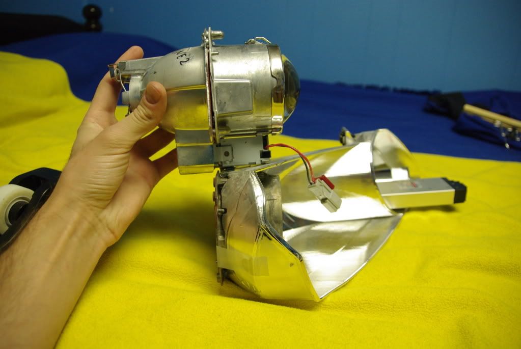

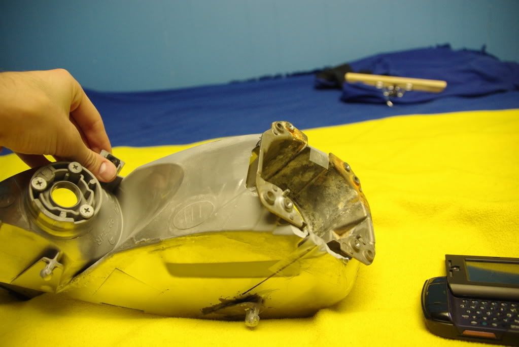

plan right now is to mount TL farther in reflector so i dont have to cut oem mounting for reflector so i can retain oem adjustment capability.
TL will have to sit farther in housing so most likely back of housing has to be cut, solution to cover that is back housings from FX35 headlights that i have which from what i measured will fit very nicely.

made middle cross cut cutout template so i can put it on back of reflector and cutout that shape. this way projector will be inserted from back of of reflector and just lens holder will be seen
might just use e-46 shrouds for simplicity pupose since it will cover everything nicely

today i marked how back needs to be cut and drew perpendicular lines for reference points. it was pain using right angle rulers and stuff but i got it done and hope it works as it should

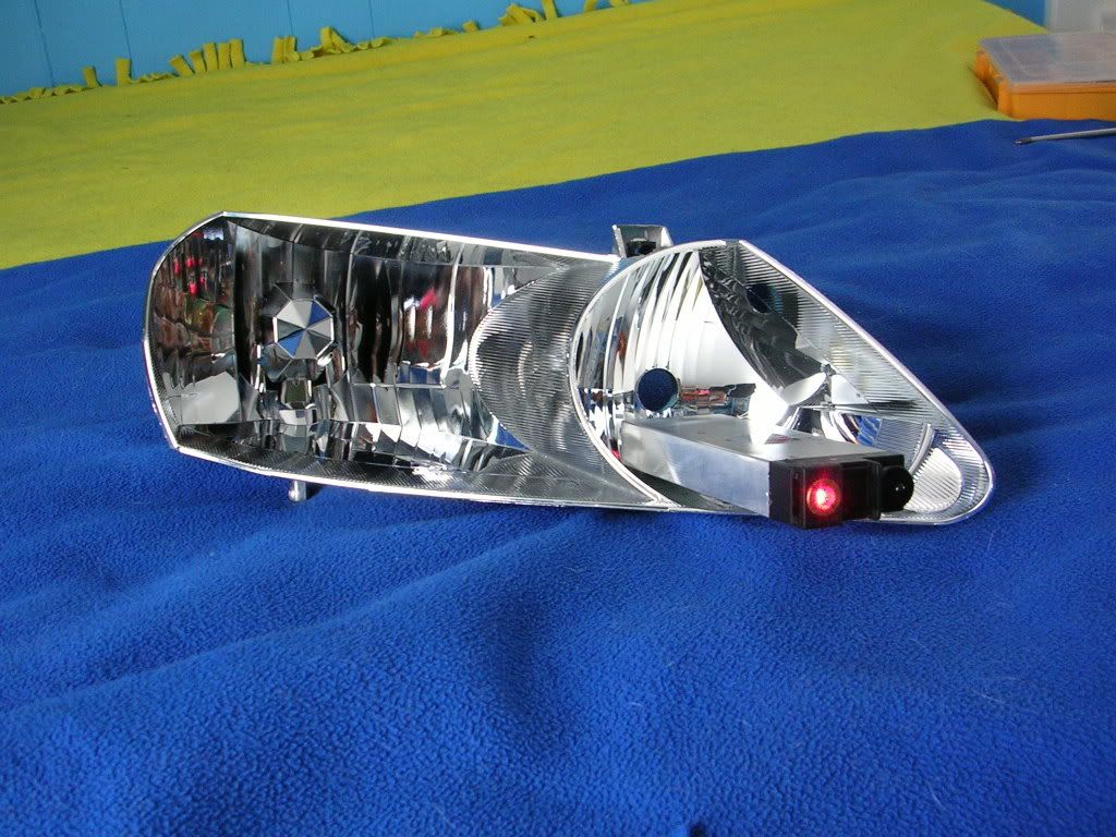

trying to figure out how to mount reflector so i can have same reference points, hmm mounting leser leveler on fecletor somewhere and using that line as reference, i will have to look in to this. now have to find cheap laser leveler

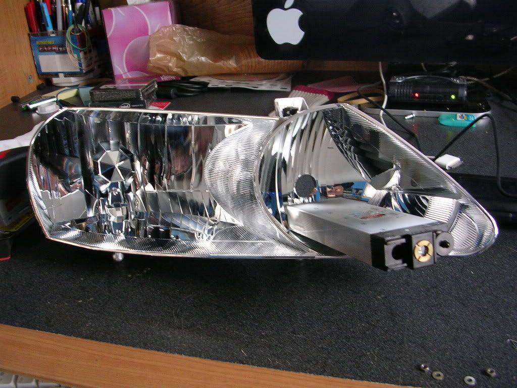

got the laser levelers at work.
i got nice idea off youtube for alignment.
here is how
put halogen bulb in. turn it on and sit reflector so beam is horisontal.
this will give you reference points.
i will do following
with this leveler if it works. i will put halogen in. mount reflector so beam is horizontal. mount this leser leveler in high beam bulb socket so horisontal lines match up. and then i can adjust beam of projector to align with beam of laser
follow what im saying? this way beam of projectors has to be horizonal
