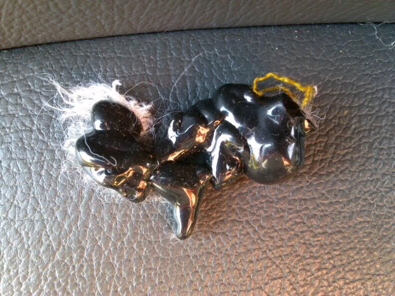

Fast forward four years and as of last week I noticed my passenger side speaker sounded like shit. So I took the door panel off and sure enough, the speaker was blown. Then I went to unscrew the speaker so I could toss it out. That's when I noticed this tar like shit around the outer edge of the speaker. I had never seen it before but I thought oh well and just peeled it off and took the speaker off.

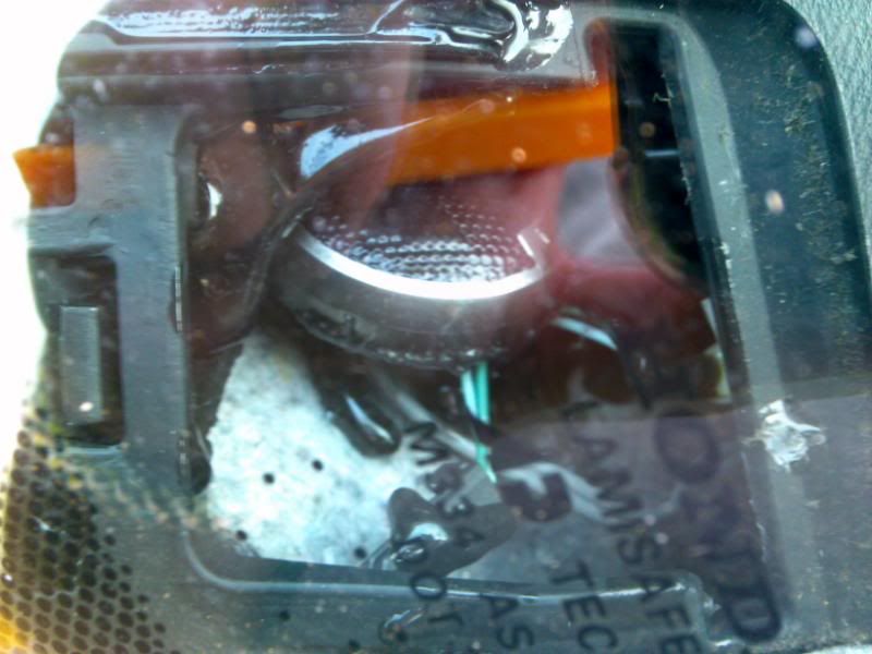

Here is what I found when I opened the driver's side tweeter grill.
Yay! More tar!
Not only did they mount it only with tar (nothing is holding it down but the tar), but they mounted it sideways pointing towards the center of the dash. Fucking awesome!
I managed to pull the tweeter out of the opening. Half of the little holes on the tweeter are clogged with this tar shit!

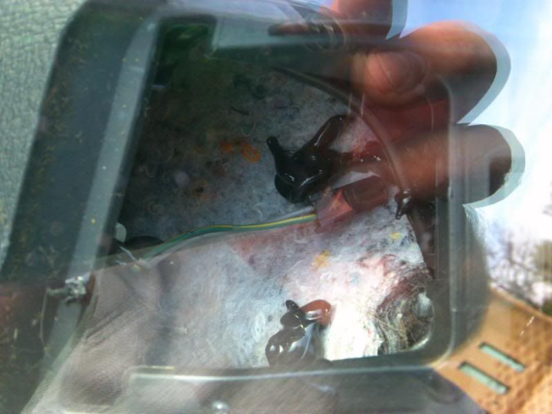

So then I move onto the passenger side speaker. I'm dreading what I'll find this time. I opened up the grill and was shocked to find...
Absolutely nothing. No tweeter.
Then I got a bit curious. Where did the tweet go? It had to be somewhere. So I start taking things apart and low and behold, what do I find after dropping my glove box?
The missing tweeter! Just chillin behind my glove box. Awesome! It takes me a good 20 mins and several bloody knuckles to pull the tweeter back up through the tweeter opening.

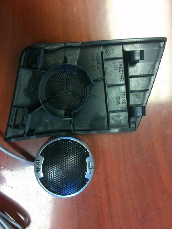

Got the new tweeter covers in. The tweeters don't fit, they are too big. I guess that explains why the originals were all cut up.
sigh

Post up a picture of your tweeter. Generally material can be removed from the outside of them without effecting performance.
Re: Got screwed by audio shop, where to go from here?
November 18, 2011, 04:03:01 PM »
It is roughly 1/4 of an inch too big in diameter. Too much to shave off I would think.
November 18, 2011, 07:00:45 PM »
There are a few things you can do. Normally, what I do is trim the collar from the tweeter panel, then mount the tweeter with whatever method you prefer. Plastic welding is usually the best method. A plastic welding kit is only about $15-20 from Harbor Freight.
