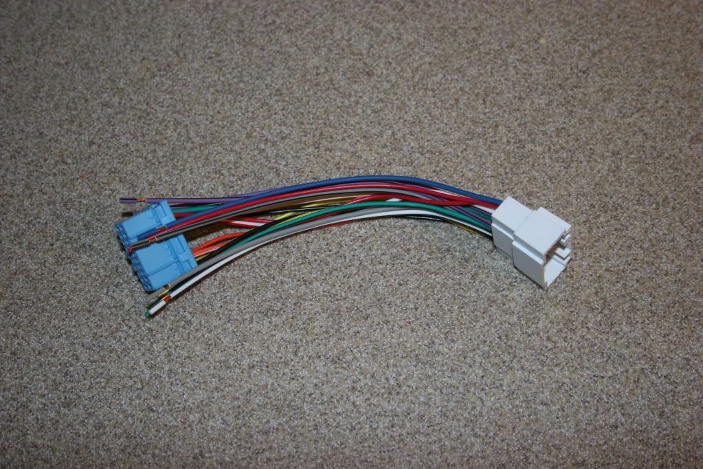

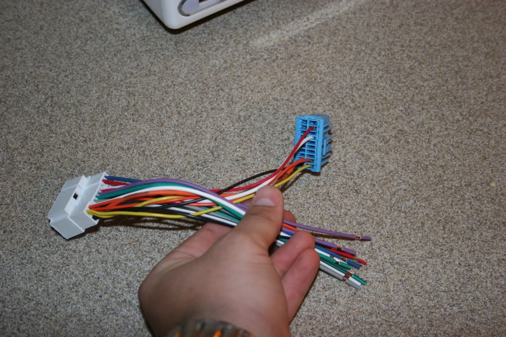

Im pretty sure thats what I have. I bought one off of ebay, the one in my car now, because I didn't realize that the crutchfield lower cubby kit came with one. I am about to upload pics, so someone can confirm its the right one. What you do is you solder the aftermarket harness with this, ending with three plugs. One goes into the back of the new h/u another goes into the OEM h/u and the other connects to the car wiring harness. It's yours if you want it. I have no need for it.
Here are the pics:
« Reply #67 on: September 27, 2009, 07:14:15 PM »
Dave, get Bill's harness.  That is what you need.

« Reply #69 on: September 28, 2009, 08:29:10 AM »
Dave that is the one you need. The one on there is Toyota specific.
