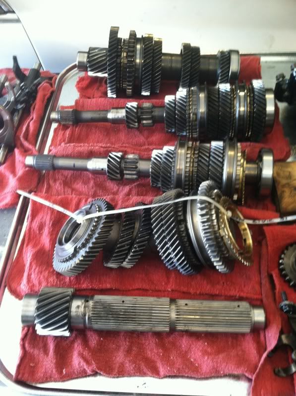

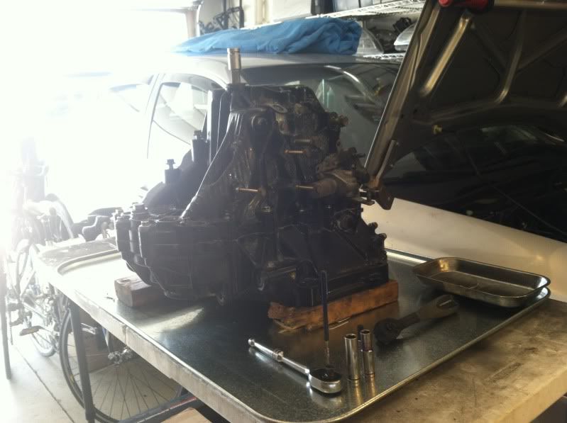

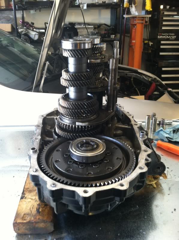

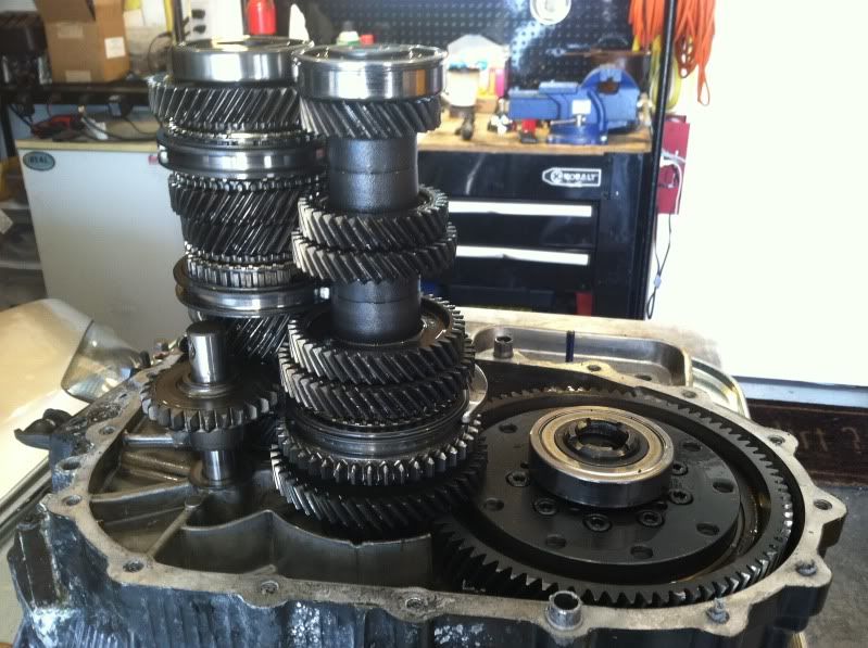

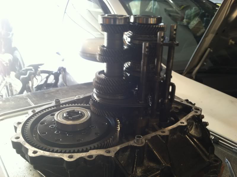

I did this today.  I'm just waiting on a new needle bearing to come in for my new final drive so I can put it all back together.
« Reply #7177 on: September 23, 2013, 07:45:01 PM »
Nice work Tim. What did you go with for a final drive? Another vehicle?
« Reply #7178 on: September 23, 2013, 09:15:01 PM »
You took pictures of tranny guts? :shifty:
Trade Count: (6)
« Reply #7179 on: September 23, 2013, 09:20:00 PM »
Damn that pretty Epik Tim. Want to help me install and LSD Smiley jp jp
« Reply #7180 on: September 23, 2013, 11:29:32 PM »
I went with a 4.052 final drive from the Indian market CR-V.  This final drive has been WPC treated.  The second gearset you see in the picture is from a FA5/FG2, which should give me more even gear spacing.  The TSX 6th gear is going on the Si gear set for better freeway driving.  There's nothing epic about all this.  I'm just trying to improve my car and expand my experience.  Service manuals are the only reason why I was able to get it all apart.  Getting it back together will be a different story.  Let's hope I can put it all back together.

Damn Tim, that is awesome! Is there a big difference between the FA5 6th gear and the TSX 6th gear?

Did something actually happen to the tranny or you just felt like taking shit apart?

FA5 and TSX 6th gear are both 0.652.  The gearset I have is just 1-5, which is why I'm swapping over 6th gear from my TSX gear set.
Nothing happened to my transmission.  I'm also not taking shit apart just because I felt like it.  If you re-read this part...
