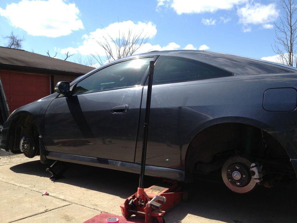

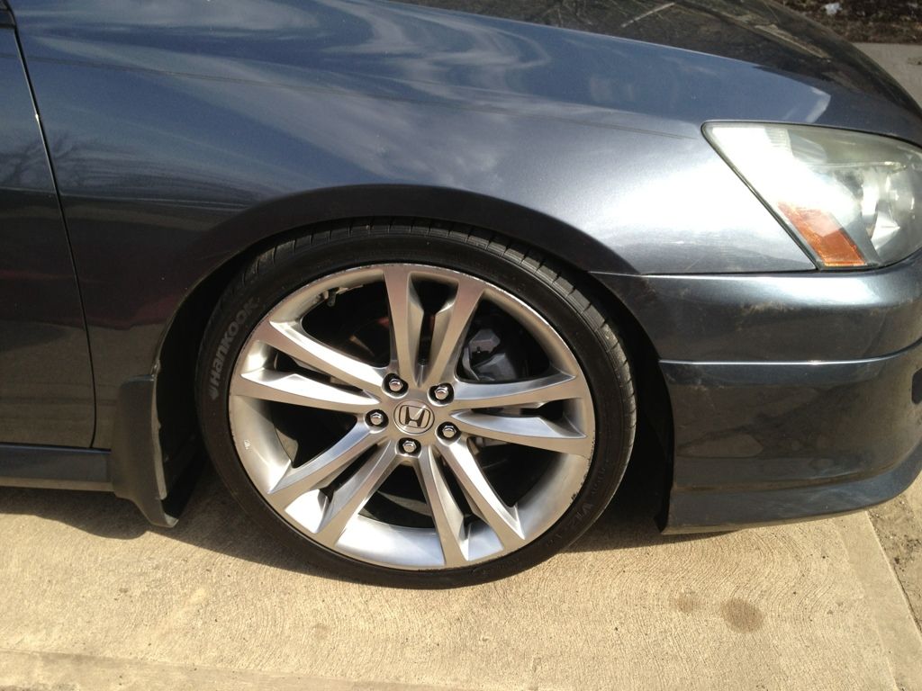

Painted my calipers:

Hey Ben those don't look painted at all! nice job!

@ Charley: Thanks man! Took me about 4-4.5 hours. Damn OCD. But it included completely removing the brackets, hanging the caliper as to not put strain on the brake hose, taping off everything that shouldn't be painted (bleeder valve, brake hose, bolts, etc.), covering and masking off the car, cleaning all brake components real good w/ brake cleaner, taking a wire brush to the brackets/calipers, first applying the adhesive promoter and allowing to dry, then about 3 coats of Dupli-color caliper paint. *wipes forehead* But in the end, it came out perfect...as I would have expected
