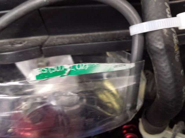

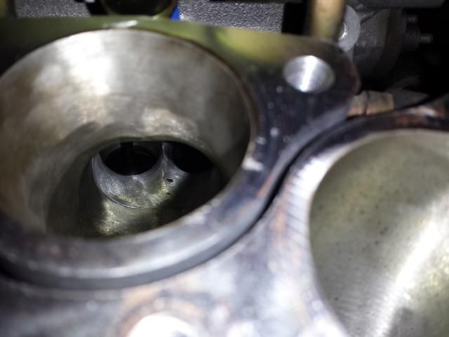

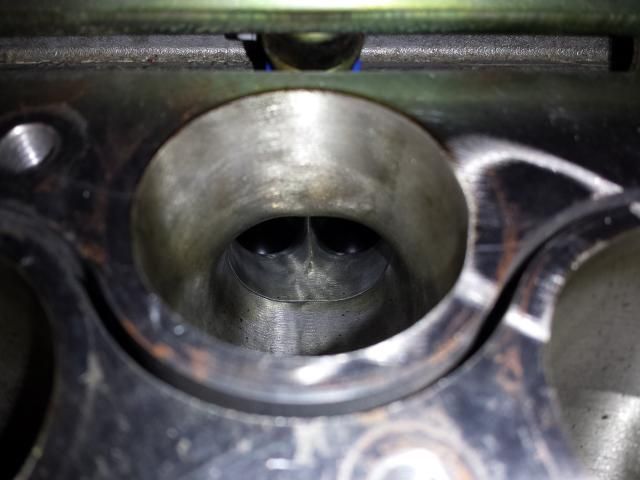

Pulled my intake mani, primed the fuel and checked for leaky injectors. All dry. Noticed that the vacuum line from the regulator that was disconnected from mani was dripping fuel. Put a cap on the mani and a plug in the regulator. Gonna order a replacement and maybe the repair kit to keep this as a spare. So we're pretty sure this is why im having issues starting after sitting for a while. Figure the fuel is dripping into the mani and over time reaching the runners. Currently, whatever fuel/vapor that may be hanging in the mani should clear up soon.

Pix of what? I took some of, as best as I could, down in the runners. I was trying to show the top of the valves. I also have one of the fuel dripping into a container from the vacuum line on the regulator. I can post these later.

Here are the pics
Here's amount that drained while I was checking the injectors
