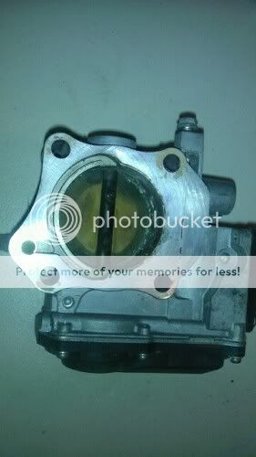

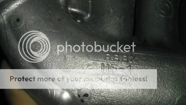

um, Tim.... just to be sure, this
is
the right one, right? the guy told me it
was
from an 05 a few times lol, double checked it when I got it, to make sure it did say rbb...
*edit* resized pic, just realized how ungodly huge they were lol
Last Edit: February 11, 2012, 10:30:28 AM by Armyguy239
Reply #4390 on:
February 11, 2012, 08:15:03 AM »
04-07 TSX IM's are all RBB. Take the TB off and show me a picture of that.
Reply #4391 on:
February 11, 2012, 08:38:33 AM »
*edit* never mind, its an 06 up, getting the right one atm..
I'm guessing no right?
Last Edit: February 11, 2012, 10:32:00 AM by Armyguy239
Reply #4392 on:
February 11, 2012, 11:32:00 AM »
That sucks dude. It's always important that you ask for pictures of the TB opening before you buy. Most guys on k20a don't know the difference because they're all using different manifolds that make power at higher rpm ranges.
Reply #4393 on:
February 11, 2012, 02:19:30 PM »
its an 06 one. If you have an 03-05 accord it won't work... Sorry. Sell it to someone with an 06-07. The TB is 2mm larger then the years before it.
Reply #4394 on:
February 11, 2012, 03:56:42 PM »
Quote from: thisaznboi88 on February 11, 2012, 02:19:30 PM
i know, thats why i edited and put nevermind I had got an 06-07 one and that i was getting the right one
