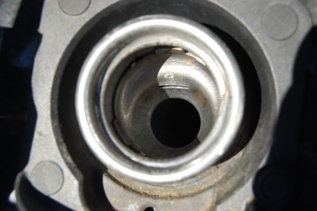

alright cool. before i get my CEL checked, i took a look to see if it was my gas cap and noticed this.
isnt there supposed to be like a metal circular plate that opens/closes when you put in gas?

Quote from: "dizzle"
yes thats normal. i noticed that when i got the car couse my 02 accord had spring loaded door in that hole

September 10, 2009, 01:28:05 PM »
ok, cause i was use to seeing a little flap there but if its normal, im all good. but i did get back from autozone for the CEL and i got a P0141. my car is around 99k miles so i guess i should replace it.
