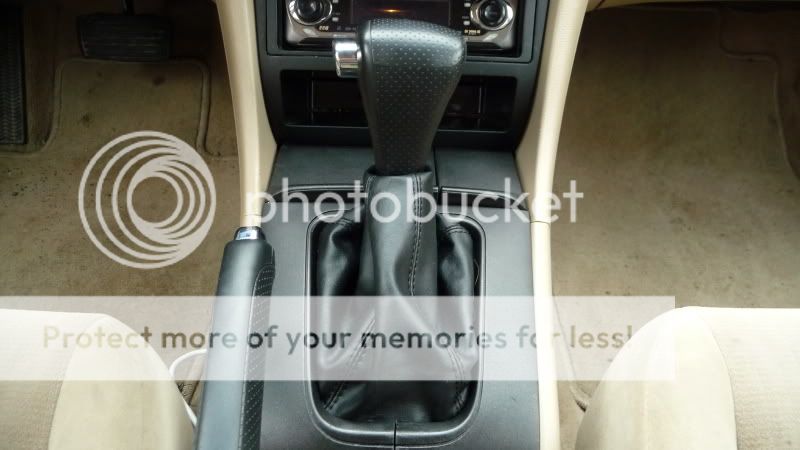

Here is what mines looks like;

nice... how did you get the top of the boot to secure to the shift knob?
mine isnt securely attached it just sorta sits in there... and it looks like i have alot more slack on mine compared to yours
it looks fine for now... maybe i'll mess with it a little more once its warmer

Heres what i did. Maybe it will help you get that cleaner look.
1. Removed the knob
2. I pulled up the trim piece
3. turned the boot inside out and removed the white trim piece from the boot.
4. Squeezed the boot "neck" in-between the two pieces of the knob. Also used zipties. but not necessary
5. re-installed the knob with the boot inside out and the trim piece in the air lol.
6. (only if you have heated seats) Reconnected the switches
7. since the knob is back on and the boot is inside out. It should look like a funnel. So just bring the trim down and secure.
