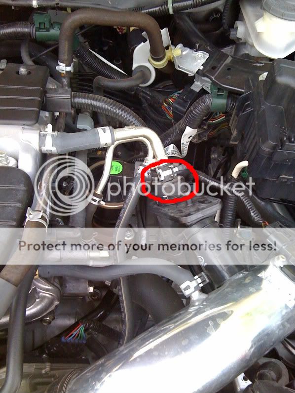

Hey guys, I have three questions. I'll keep it short. I was changing my oil and my drunk father came and took the oil and poured it for me while I was gone and he ended up making a mess having it spill on the engine and it ended up going deep down in the engine bay. I read the manual and it said that any oil that gets onto the engine compartments could damage it. Should I really worry about this?

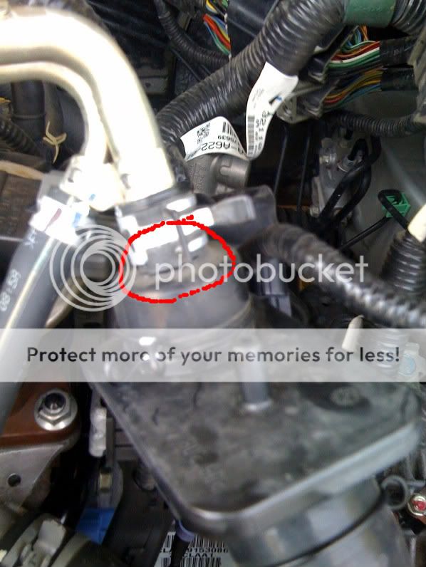

Also one of the rubber parts close to where my CAI is cracking...Again, should I worry about that also? I'll post a pic of it when I get a chance.

As far as the oil, just spray some degreaser on a cool engine. Wait a few minutes and hose it off. Don't go crazy with the water, too much is a bad thing.

For that cracking part, you can get a replacement here:
http://www.hondaautomotiveparts.com/aut ... R+%28L4%29
part number 2
I didn't know if your car is an 05 or not, but I could tell that you have a MAF, so I assumed that it was. And I think you put that part that's cracking on backwards, lol. Take a look at the illustration.

It's part #3 that needs replacing Jeff, not #2 and I think your right about it being upside down.
Drunk pouring FTL....I would do what Jeremy suggested though and get a funnel next time ya pops try to do something like that again.
Aha, it is. I forgot that the part that's cracked isn't a part of #2, lol. My bad.

Thanks-a-million guys! Slipkord, I recently degreased and washed my engine bay so that's a relief now, thanks! I went to the stealership and had no luck because they said their parts store are backed up on order for this particular part so I guess maybe I can manage. The crack isn't all that severe BUT i'll reposition the joint I put in wrong. Thanks for lookin' out Jeff.

Another thing to keep in mind is that oil eats away at rubber (in a way) so try to get it off hoses, bushings, and couplings asap.

Cool...He would have to get the correct part number from hondapartsunlimited.com or bkhondaparts.com cuz I think Majestic uses a different number to describe/label their parts.
I've also notice some people eliminated that breather joint altogether and just put a hose there. I dunno what kind of benefit that would accomplish though.

If I'm not mistaken, that cracked hose is a part of the blow-by thing, which usually spits oil back into the intake. That's what I was talking about, not the spilled oil. :mrgreen:
