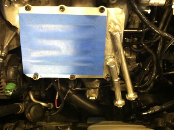

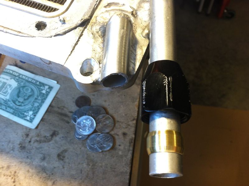

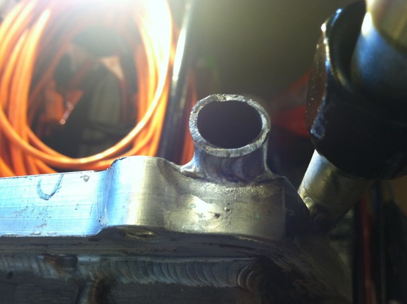

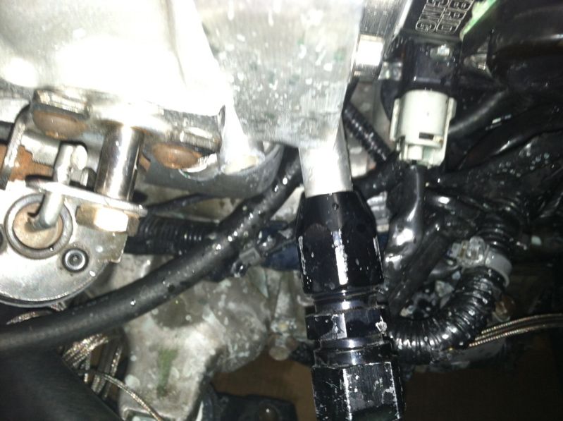

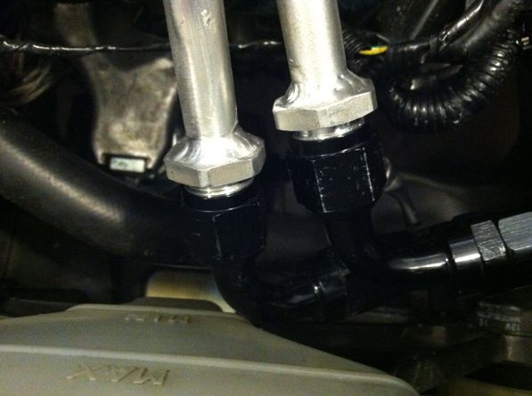

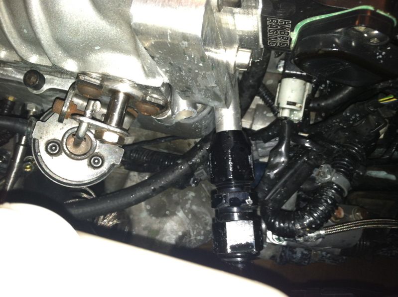

My aftercooler coolant outlet broke, so I had to pull the supercharger off to get it fixed.  While it was off, I had fittings welded on.  I just picked it up last night to test fit everything and make sure the lines clear my coolant overflow tank.  It will be going back on today.
Here it is all fixed up.

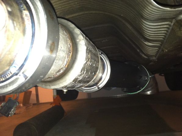

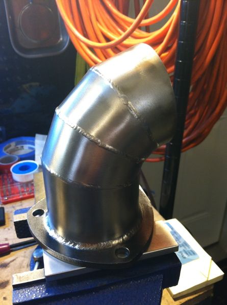

The flex pipe on my header was destroyed.  It's had a leak since I first got it, so this needed to be replaced too.  I decided to do a few upgrades there too.  Since I had everything off, it was time to upgrade and fix some problems with my exhaust.  I decided to make the flex pipe removable so if it breaks again, I can just have some v band flanges welded on and replace it in a few minutes.  I also wanted to get an exhaust cut out, so I had that added to my set up.  All I have to do now is cut the mid pipe and weld on a new v band flange.
Here's the damaged flex pipe.  Kinda bad for it only being on my car for 7 months of use.  It sat in my garage for a year and a half.
Here's what's done so far.  The electric cut out I picked up was mis-packaged so I ended up getting a 2.5" one instead of 3".  I have to take it back to have them exchange it for me.
Here's the turn down for the exhaust cut out.
